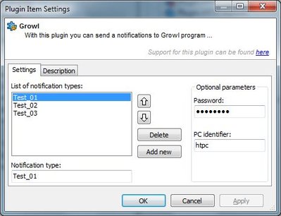

There is one thing which might enhance my setup even more: As I have four machines running here in my network all with eg and growl it would be nice to forward some the eg messages from one machine to another via growl.
Now when I do so the eg application inside of growl on the receiving machine will be overwritten by the one coming from the sending machine. Is it possible to tweak something so each eg plugin will be unique in my network?
This means eg on the htpc should register as eventghost@htpc and eg on the whs should register as eventghost@whs in growl so it would see them as different applications.

Hi pako,
thanks for looking into this!
I'm gonna post some screenshots to show how it works on my network.
In this example I have three machine talking to each other via growl: The WHS, the workstation and the htpc.
These screens are from the workstation: You can see in the applications tab that there are several apps registered to growl. Only eventghost is running on the local machine (workstation). The others run on the whs. They are shown cause I subscribed the workstation to notifications from the whs and on the whs forwarding to the workstation is enabled (by default in that case but you can configure that independently for each app).
You can see on the second screen how this is configured on the workstation: As you can see on the screens I would like to forward the eg messages from the eg plugin running on workstation to the htpc. But as it is already running its own eg plugin this won't be possible... The evenghost plugin/application in this screen would be overwritten by the one shown in the screen above if I would really forward it to the htpc....
I hope this helps you to understand the purpose of my question.

Re: Growl
Hi pako,
thank you so much! I had a detailed look at it and it is working like a charm!
All machines are set up and there where no errors, none in eg and none in growl either....
I didn't think about the password feature, it is great that you did...
Thanks again!
Luca
Thanks again!
Luca
