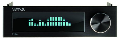

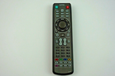

If I press a button on the remote, EG responds and sends the code in the program. So that works, regarding the errors code.
No such luck with the number keys however...
And my display is now blank as well...

Now the issue with the remote right now should be an easy one to solve.. I created a wrapper class around integers that would provide a string that could be used as the event name.. each remote button is given a number to represent the actual button. I wanted to try something new with wrapping a string as an integer and still be able to access the underlying string.. This may or may not work.. who knows.. the idea is sound enough and made it worth an attempt. otherwise I am going to have to go back to the "traditional" lookup table methods. which is a non issue But I wanted to try and keep true to form with the iMon API and keep the enum structures in pace that contain the integer values.
I do not know exactly where the failure point is. it may not be returning the right things when i am pulling the numbers. I have to go and check.. I should have a solution in the next 10 or 15 minutes..

Yes, my remote control is the same as my display.
I don't mind the display. I did find some problem when using Kodi. When I play a song, it doesn't seem to show trackinformation on the display.
It also doesn't find Kodi. But it does support XBMC. I thought I could maybe fix this in iMon itself, but I tried to make a symbolic link, but it doesn't seem to work.

iMON.Display.Connected (0) 'NoInformation(1)'
iMON.Display.LCD.Unsupported
iMON.Display.VFD.Supported
iMON.Display.TextScrollComplete (4096)
Re: SoundGraph iMON API Plugin
the display side of it is working...
have you tried pressing a button on the remote??
also there are 2 spots to enable plugin mode.. one for the display and one for the remote... so you will want to check that. I am going to try and install the iMon software and see where i can get with it.
