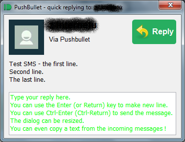

Another change is the improved Quick-Reply dialog:

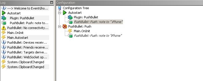

Great application ! Does anyone know if its possible to write a .bat file that automaticlly can notify a device (iphone) with a note or a file? In other words, running the .bat file automates it. I would really appreciate an example here of how that .bat file can look like. Today, I have to manually right-click a file and choose "Pushbullet" and choose device. Or in the application itself do the commands, I'm using WIndows 7 and would like to do the notification towards a second device (iphone).
Now I have, what I think, everything installed on my PC. Eventghost, on right half of screen it says: Autostart Plugin: PushBullet PushBullet: Push: note to "iPhone"
But I still dont understand how to create a bat.file that automaticlly trigger Eventghost to send a note to my Iphone. Tried following script in bat-file. "start C:\EventGhost\EventGhost.exe -event Autostart"
EventGhost starts but doesnt Execute the tasks under "Autostart"
If I instead manually press "Execute" at Autostart in Eventghost, its pushed a note to my iphone but I want it to be triggered automaticly via the bat file... please help

fokker70
Posts: 6
Joined: Tue Sep 02, 2014 11:43 am
Re: PushBullet plugin (Pako)
Post by fokker70 »
Pls check my comments below
Stimuli that trigger Eventghost could be bat-file, folder change, or anything that can be accomplished automaticly without manual effort.
#1) I do not understand why you need a bat file?
I dont want manually press execute in Eventghost. I need a "trigger" from outside, therefore the use of bat-file.
#2) You can not to use the Autostart (it runs only once, automatically at startup EventGhost)
No. the Push event under Autostart doesnt run Automatically at startup of some reason. Only when I press Execute manually in the program
#3) You need a separate macro, outside Autostart
Do you mean a seperate folder outside the Autostart folder but still in the Eventghost application?
fokker70 wrote:I dont want manually press execute in Eventghost.
That does not automatically ! However, it is possible ...
fokker70 wrote:I need a "trigger" from outside, therefore the use of bat-file.
Macros in EventGhost can be triggered by many kinds "from outside".
That's why I always ask what should be a stimulus to run.
fokker70 wrote:No. the Push event under Autostart doesnt run Automatically at startup of some reason. Only when I press Execute manually in the program
Note, that after running EventGhost takes a while "PushBullet client" is ready to work. Probably for this reason it will not work.
fokker70 wrote:Do you mean a seperate folder outside the Autostart folder but still in the Eventghost application?
Of course.

Lets say a folder change can make EventGhost to fire a note to my iPhone. How should that be accomplished?
I understand a bat-file is not possible then (?)
I dont think thats the reason. I have attached a screenshot of the folder view. Maybe you see any error here?
