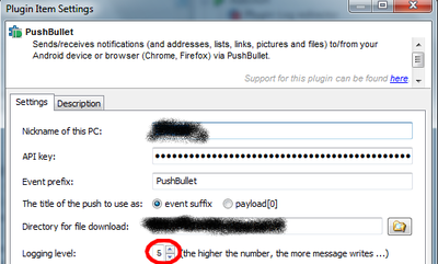

Please set Logging level to a value of 5.
Then attach a long passage.

Re: PushBullet plugin
thanks, Will do. How to I change logging level?
Phil wrote:thanks, Will do. How to I change logging level?
