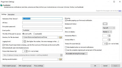

Thank you very much for quick response and all the work that you are doing here. I am completely new to home automation and finding that it is a very steep learning curve. I quite enjoy tinkering and getting things to work but at the moment I feel stuck as I spent 5 hours on youtube, this forum and and internet searches but made no progress.
I followed the guide in this thread to the letter and managed to get IFTTT set up and PushBullet linked. So that when I say the trigger phase, I get a push bullet notification on the computer.
I also managed to get the push bullet plug in to appear in the Event Ghost. However, when it comes to configuring EG PushBullet plugin I am completelly lost. Since I cannot donwload __init__.py I am not whether that will solve this problem.
In my head this boils down to two questions:
1) What function does the __init__.py perform in the EventGhost?
2) What do I need to put into the PushBullet Plug In item settings for it to start being triggered by notifications?
Apologies, if this has been covered somewhere in the guides already. If that is the case would please kindly provide a link to the guidance.
Thank you in advance for your help

ok this is what I want you to do..
download the attached file. decompress it to C:\Program Files (x86)\EventGhost\lib27\site-packages\requests
It is going to ask you if you want to overwrite the exiting file.. say YES
see if that solves the issue.

OK folks This should be working now.
I bundled the cacerts.pem file with the plugin so it will be easier to update when it goes out of date.

well it... it really doesn't work like a charm. I keep on getting this blasted error
and I am not able to send files.. there are a few other things that are non functioning also.. The API manual is horrible. so it's hard to tell what needs to be done.
PushBullet: Request error: 403:{"error":{"code":"insufficient_authorization","type":"invalid_request","message":"Insufficient authorization.","cat":"(=^├óÔé¼┬Ñ^=)"},"error_code":"insufficient_authorization"}

OK I have fixed the file uploading from EG to PushBullet. I also fixed the collection of SMS messages from other devices.
If there are any other issues let me know. I have a decent understanding of the API now.
