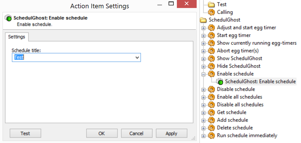

Pako, thanks very much for taking the time to explain. It still took me a few minutes to realize what you were describing. The key point you made that I needed to understand is, "But you'll need one extra schedule." Create the periodic schedule, then add a second schedule that enables and disables the first one at specified times. To paraphrase the process for others, like me, who might need help with the concept:
1. Create a periodic schedule (no span for this one unless you want to trigger a start AND stop at the periodic times).
2. From the SchedulGhost macros that were created when the plug-in was installed, copy the "Enable schedule" and "Disable schedule" macros to a new folder.
3. Configure those macros to control your periodic schedule:
4. Now create a second schedule in SchedulGhost. This one will be used to enable and disable the first schedule. In my scenario, where I wanted to start and stop at 0800 and 2300, the Start would be 08:00:00 and the Span would be 15:00:00 (HH:MM:SS). The "Start event suffix" will be used to generate an event to enable the first/periodic schedule at 0800 and the "Stop event suffix" to disable it at 2300, similar to Pako's screen cap:
Thanks again Pako for creating this plug-in and helping me understand its use.

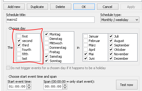

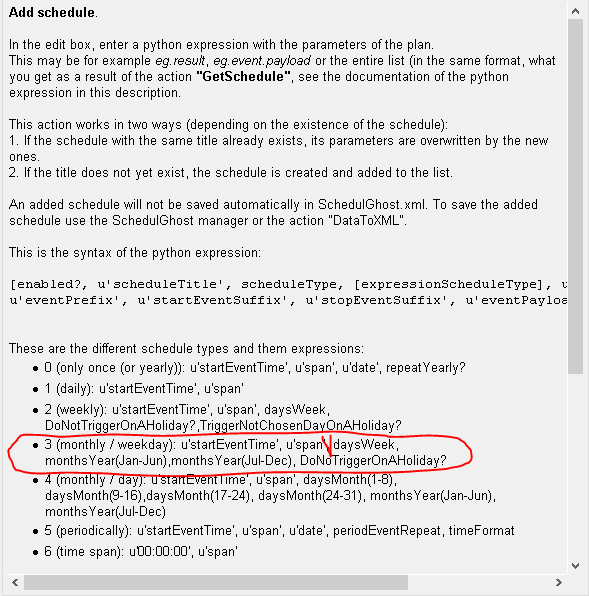

Just a little thing I noticed: In the documentation of schedule Type 3 in the Add schedule function the entry for "first, second, third... (Monday)" is missing.
Re: SchedulGhost
I'm sorry, but I did not understand it.
Can you please explain it in other words (with regard to my poor English) ?
Thanks, Pako
Sem;colon
Posts: 625
Re: SchedulGhost
Post by Sem;colon »
My English is not better, I guess :)
Let's show it to you with pictures!
Re: SchedulGhost
Yes, now I see it.
Of course you're right.
Perhaps I am a little excuses, that it was not me, who wrote this part. :)
The extended description of the action AddSchedule I have taken over from EventGhost4ever (see post of Tue Aug 14, 2012 3:33 pm).
But the truth is that it was my duty to check it ... :oops:
In the next version I'll fix it. Thank you for reporting and visual explanation!
EDIT: The new (corrected) version 0.1.7 is available for download.
