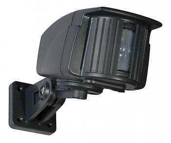

There are several wireless IR detectors and magnetic door contacts available as example

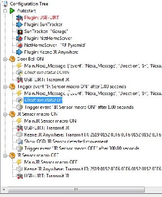

The following picture shows a very simplified version of my own EG setup that is currently in testing in my house
As before, I have my SunTracker plugin running to control my outdoor lights using the USB-UIRT and a Powermid Pyramid transmitter (IR->RF). I wanted to add some alarm monitoring to EG
If someone is walking in my garden adjacent to my garage when the sun is down I would like that the lights are turned on. I therefore use the IR Motion detector signal that triggers a macro. The macro itself schedules another event that runs a second macro that turns out the lights again after a predefined time period
To check the status of the sun, I use two simple python scripts in the macros like the following
Check sun status DOWN
Check sun status UP
In addition I have played with triggering the new KeeneIR control to control some additional equipment
When the sun is up, the IR Motion detector signal is instead used to start a door bell (rf receiver)

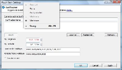

Thanks for all your work in this!
I'm not quite certain if I'm missing something but I can only input two numbers followed by four decimal points for my lat and long.
My lat is +50 and my long is -113 (plus some decimals). How can I enter the -113 into the configuration?

Hi, you mean like this?
Stepping up/down with the arrows takes too long time, agreed. Try to select/mark/highlight the values and start typing in your values instead

Ah hah! I just notice that you have longitude first, latitude second. I'm an idiot. I was trying to type lat into the long field and vice versa.
So much for reading the fields instead of just assuming the standard lat/long.
Cheers!
Cheers!
Re: SunTracker plugin - with moving ghost
But you are right as well, if latitude/longitude is the standard order I can easily change in next version. It will anyhow be interesting to see if it works ok in your position (Calgary?)

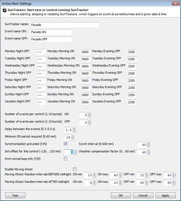

I have updated the SunTracker plug-in with a new feature and also made a small modification to how the threads are executed
The new feature is a weather condition compensation factor that is used to adjust the firing of ON and OFF events. The reason behind is that a clear day, lights could go ON a bit later than a day with clouds or rain
As source for weather information, Google is used so you need a permanent Internet connection for this to work
You can define the total amount of additional time to calculate with. Lets say you enter 45 minutes. The script will then, depending on actual weather conditions, calculate if time should be added or subtracted according to the built in rules.
The rules are as follows
"Cloudy"
"Fog"
"Rain"
"Light rain"
"Rain Showers"
"Drizzle"
Will give full prior compensation, means ON events will be fired specified time EARLIER and OFF events LATER
"Snow"
"Light snow"
"Mostly Cloudy"
"Partly Cloudy"
"Overcast"
Will give half prior compensation, means ON events will be fired half of the specified time earlier and OFF events later
"Sunny"
"Clear"
Will give full latter compensation, means ON events will be fired specified time LATER and OFF events EARLIER
I hope this was understandable
In the picture below I have inserted 45 minutes.
This value will also be used in combination with eventually defined offset value to calculate the total time compensation
After running this in test for the last 3 weeks, I feel that it works really fine and it is ready to be shared with you
The modification to the thread execution was made because I often had problems when multiple threads was hitting the same hardware device (in this case the USB-UIRT)
I therefore introduced a random delay between the thread executions. This did not solve the problem completely but it improved (in a separate thread I have also made a proposal to change the plug-in for the USB-UIRT to handle retries)
To install, close EG, just copy the two files from the zip to the SunTracker folder. When you start EG again you will get error messages because the actions need to be re-configured. Double click on them, change or leave the default value for weather compensation and save again.
Once done for all SunTracker actions, save the EG configuration and restart EG again. This time you should not get any errors
It is also possible to edit the xml-file directly if preferred
Best regards & good luck,
Walter

I have also added a "getter action" to the plugin that allows you to request the sun status from other plugins or scripts. Typically such a python script could look like this
The function call returns a bool (True if sun is up)
I have updated the plugin with the mandatory GUID entry
bSunStatus = eg.plugins.Suntracker.GetContentsOfVariable()
if bSunStatus:
print "Sun is up"
eg.StopMacro()
