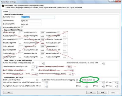

To make it easier to verify the function, I suggest that you temporary change the time settings to much smaller values and then set the PC clock so that you are simulating a sun down state. I have made my settings like this:
I have two controllers running with the same settings and they are activating ON/OFF randomly with some difference in between as I expect. If you change the external trigger with "eg.plugins.

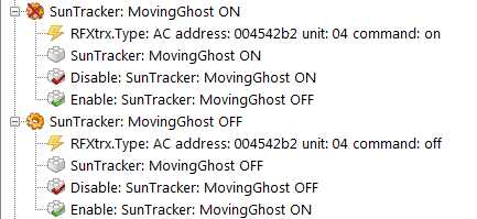

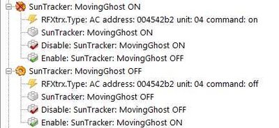

I defined two simple macros to toggle the function (just using a simple RF remote control, the disabling/enabling the macros when they are triggered, is not needed actually)

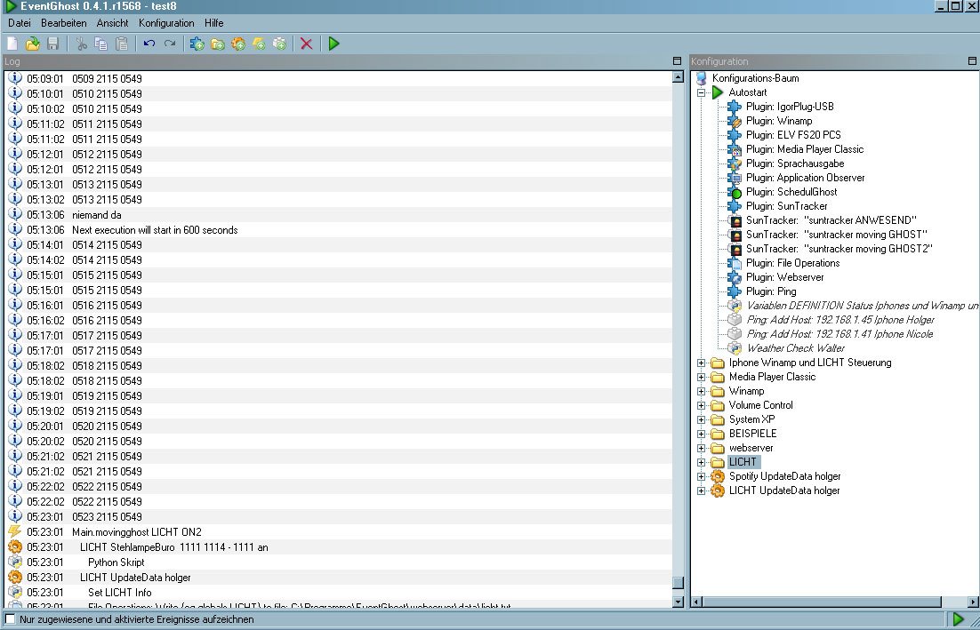

- there is now a printed statement in the log when the GMG is starting and ending (this can easily be commented out when we have verified that everything is working as expected)
