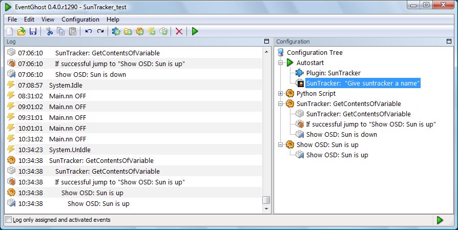

I have received a question how to use the action "GetContentsOfVariable"
Firstly you can use it in a python script or from another plugin
The call will return a bool (TRUE if sun is up, FALSE if sun is down)
Secondly, you can also use it in a macro in combination with the action "If successful Jump to" like in the picture below
bSunStatus = eg.plugins.Suntracker.GetContentsOfVariable()Secondly, you can also use it in a macro in combination with the action "If successful Jump to" like in the picture below

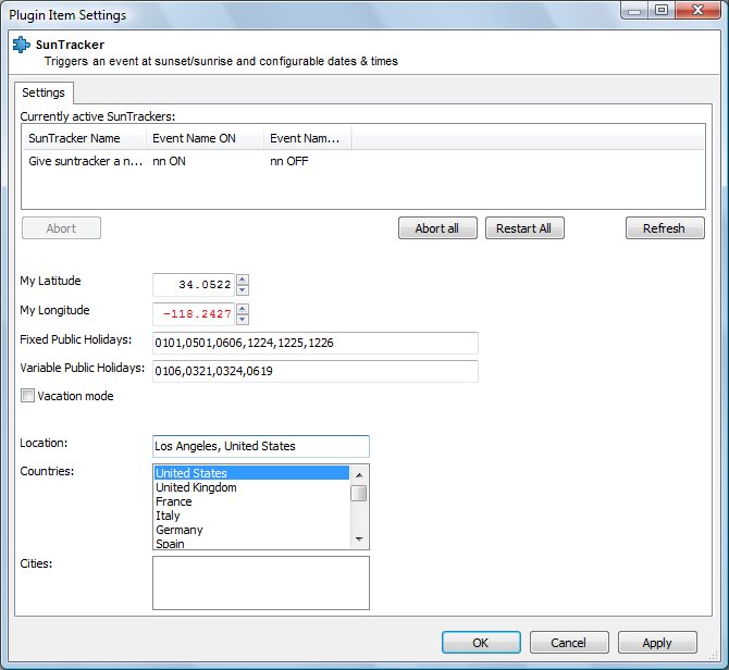

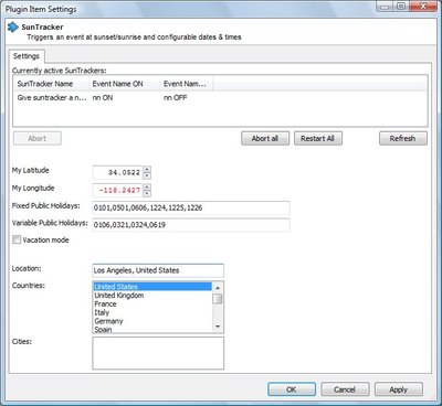

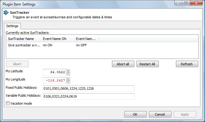

Hi, I think you need to review your settings for Latitude/Longitude. The picture below show settings for Los Angeles, California. To find your location you can use
http://www.satsig.net/maps/lat-long-finder.htm
This should help to get correct time values
I have however noticed that I do not get any weather data from Google with these settings. I'm considering to make an updated version so you can enter City/Country as location for the weather info
Best regards & hope it works, Walter

adrenarush
- Posts: 9
- Joined: Thu Feb 04, 2010 3:02 am
That was it, missed the "-" on the Long. Thanks
