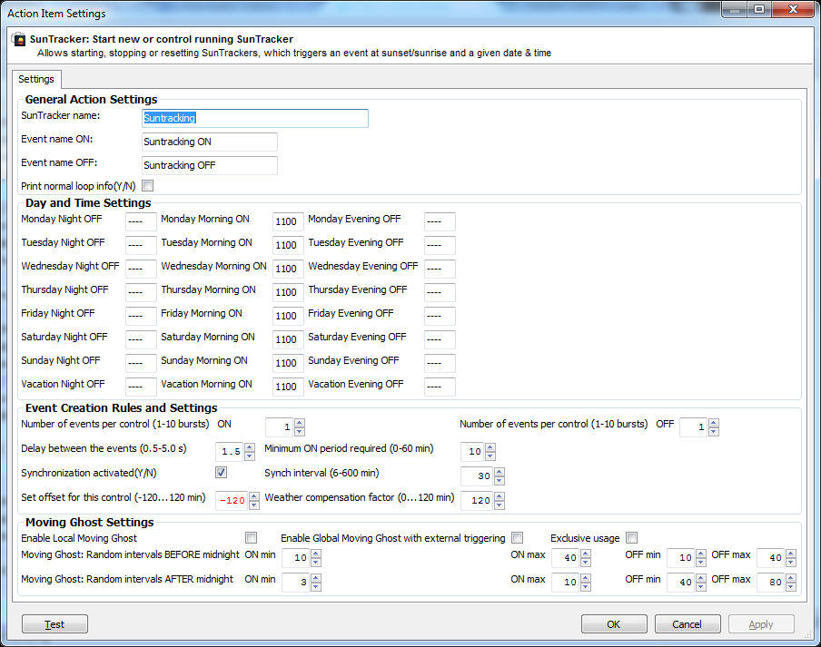

I've decided to give a try to the Suntracker events generator dialog instead of generating and polling the weather events then querying their status (that btw, works just fine, but generates a lot of garbage on my logs and it's kinda counter-productive)
And I am failing miserably...
I get no events at sunrise/sunset according to what I've put at the "Event Creation Rules and Settings" section below:
If I remove all the times from the "Day and Time Settings" I get only Suntracker OFF events every 30 minutes (as the interval I've set at the "Event Creation Rules and Settings" section)
What am I doing wrong?
Thanks in advance.
Looks ok I think but there is a dependency to the plugin settings also. Could you please paste a screen-shot of the actual plugin settings as well?

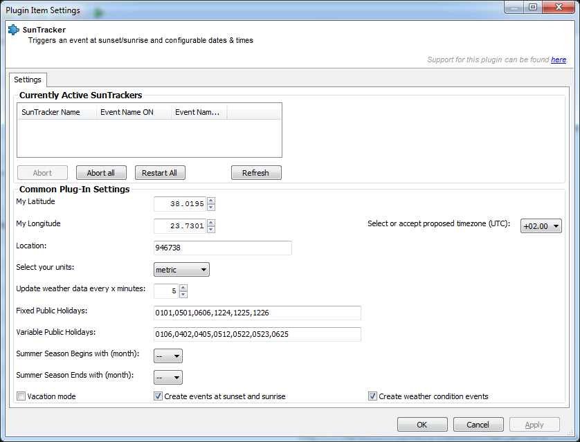

BR
Saxtus
Posts: 42
Joined: Wed Jan 02, 2013 3:37 am
Location: Athens, Greece
Post by Saxtus »

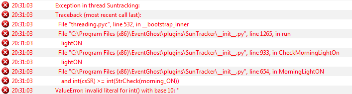

And I've noticed that I get this on startup:
Saxtus
Posts: 42
Post by Saxtus »
Generating the report here, solved the problem!
To take the middle screenshot of my last post, I've moved the SunTracker autostart actions to the top and that way found out what was causing SunTracker's errors:
Exactly before it was called (while it was at the bottom of my autostart actions), I was calling a macro that had an action "Find window" while searching invisible items too.
That takes time and it was making EventGhost to freeze for few seconds. It seems that EventGhost or your script didn't like that.
Now it's working just fine.
