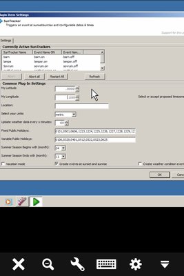

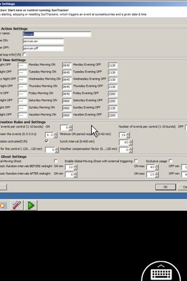

Problem when EG is restarted.
latest version of EG
latest version of SunTracker
I am Administrator
UAC is turned off
Windows 7 home premium 64 bit
I close EG manually with the X in top right corner
I start EG from StartMenu
i open suntracker plugin from EG configuration menu "Autostart"
Currently Active Suntrackers-list is empty
If I press "Restart all", all my SunTracker items will be visibe in the Currently Active Suntrackers-list
This i have to do everytime i restart EG
I had same problem in XP embedded SP2
Any ideas?

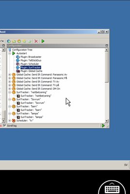

Show a picture/screen shot of your config tree so that we can verify where you put your suntracker actions
flopp
Posts: 17
Joined: Mon Dec 24, 2012 8:00 am
Post by flopp »
krambriw wrote:Show a picture/screen shot of your config tree so that we can verify where you put your suntracker actions
Thanks for quick reply.
See added pictures
Hello, I see the problem now and it is easy to resolve.
The SunTracker actions you have created are fine but they will not automatically start when placed in the config tree like this. You can do it in two ways:
a) You drag and drop them under the "Autostart" and below the actual SunTracker plugin itself
b) You add the event 'Main.OnInit' to each of the macros, 'nattbelysning', 'Sovrum' etc
I would use the b) alternative
PS you need to set the longitude and latitude correctly to get actions working according to sunset/sunrise. To get correct weather information, you need to set your location
flopp
Posts: 17
Post by flopp »
I do use Long/Lat, but i erased them when I added the pictures to the forum.
Thanks for the help.
flopp
Posts: 17
Post by flopp »
krambriw wrote:Hello, I see the problem now and it is easy to resolve.
I worked. Thanks again.
