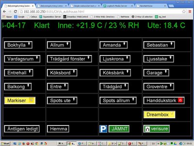

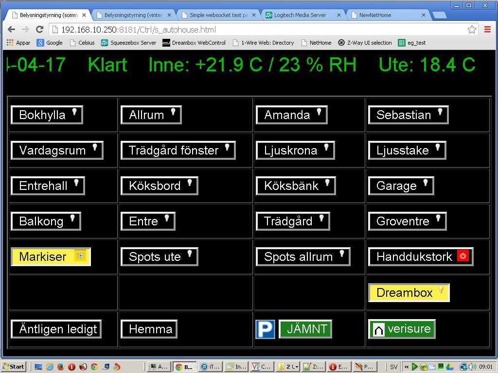

My settings are updating weather data every 5 minutes and I get an event every minute because I need it for a specific purpose
Reason is I have a web page on android tablets showing current status of various things and it is updated with your Tornado plugin with websockets. The current html coding could eventually be improved so that I could avoid to update all the time but it works fine right now so I left it as is.
In the web page (see picture below) I have a banner showing a mix of information as well as a number of buttons to control and show status of lamps and other things. Everything is updated using websockets and it works very well.
My best regards, Walter
