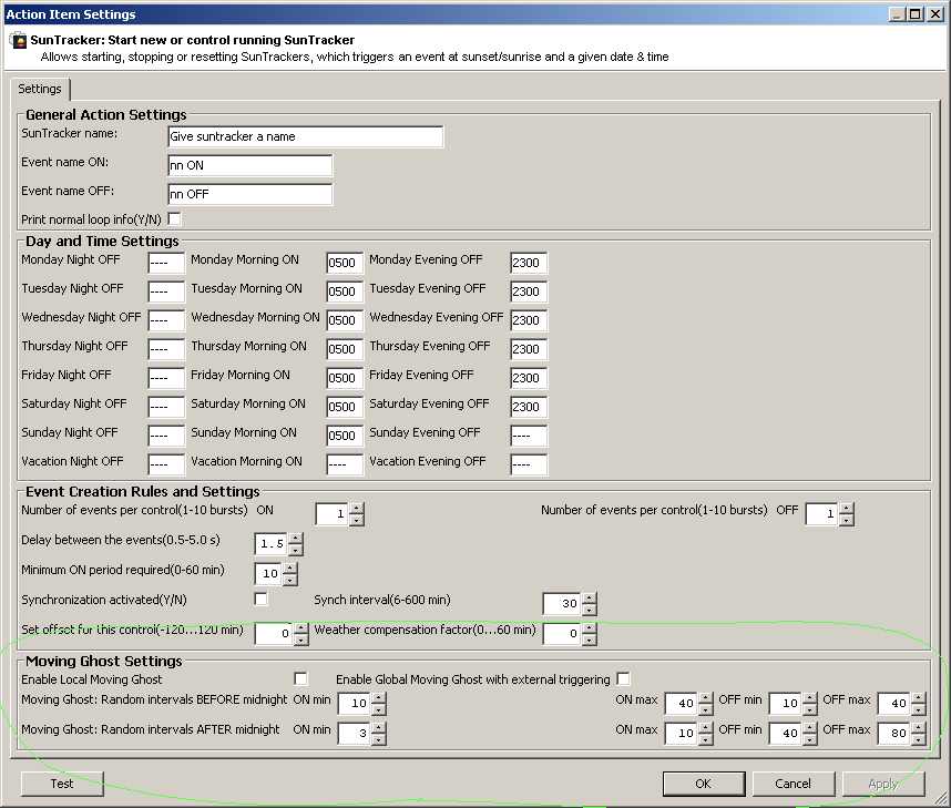

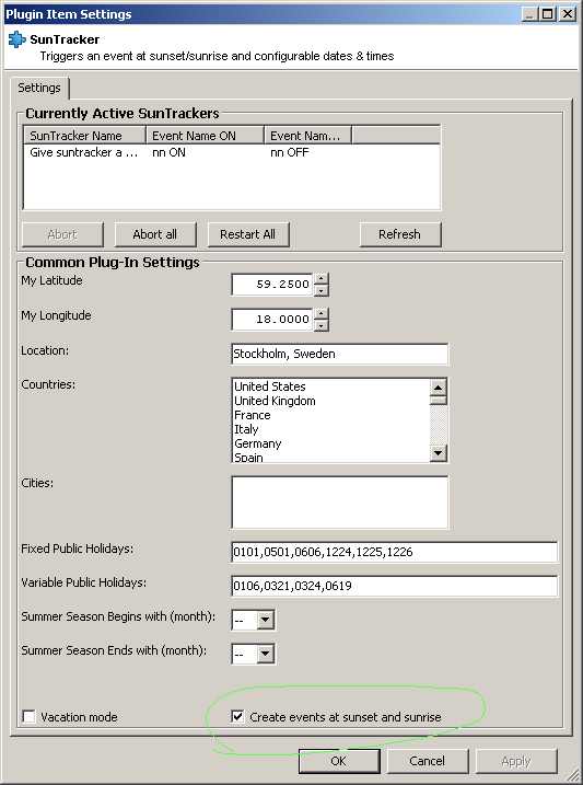

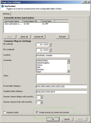

I made a new version that has the new functions described below.
Before upgrading, take screen shots or make notes of your current SunTracker configurations, I can't make the configuration compatible with the previous version :(
# General events for sunset/sunrise can now be triggered if enabled, see screen shot below
If you only need this function, the plugin takes care of it and you do not need to configure any actions at all
# I have added a global MovingGhost variable and related actions that allows you to set a global MovingGhost function to ON or OFF. As example you could have a key switch for your house that turns the function ON/OFF. Any other input device of your choice can of course be used as long as they generate ON/OFF events that are activating the macros where the actions are placed
As you can see from the screen shot below, you can select if the SunTracker action shall be
- running MovingGhost function locally (as before)
- running MovingGhost function globally and controlled by actions (i.e. the key switch or something else)
So you can have a couple of them running locally independent and some globally controlled if you like

downloaded the new version and sundown sunrise was working like a charm out of the box, when i configured the rest it works like it is supposed to, got my FS20 PCS yesterday and have it working allready, now i am just waiting for the first sundown to see it working for real (outside of activating an action manually)
just have one question. how is the weather condition stuff working, the log just says "Google weather data not aviable" every 11 minutes, when i check manually i instantly get a "condition report" over google. could it be that my cityname contains an ├╝ (u umlaut) and the plugin cant handle "non standart" letters?
Good to hear!
I created a bug in the weather stuff and I'm working to fix it asap...until then you will have those logs
The normal operation would (when the bug is fixed) be that lights will be turned on at sunset and off at sunrise but if you have set a time for weather correction, the times will be adjusted depending on the actual weather (if it is clear you can wait a bit to turn them on, if it is cloudy we need to turn them on a bit earlier etc)
Umlaut should not cause any problems, the plugin is supporting utf-8
To use only the sunset/sunrise events, you do not need to create any action, the plugin is generating those itself
New version uploaded. The weather data compensation works again ;)
