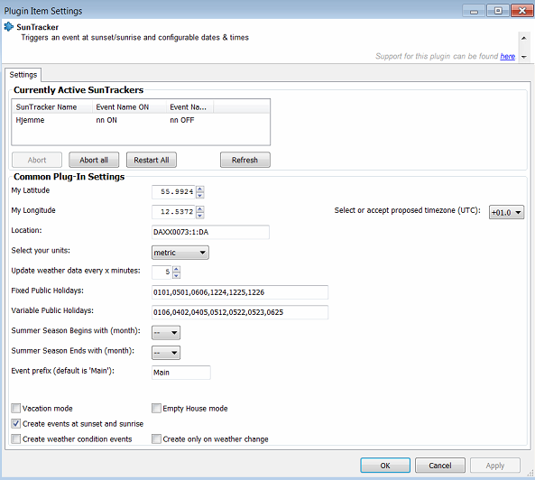

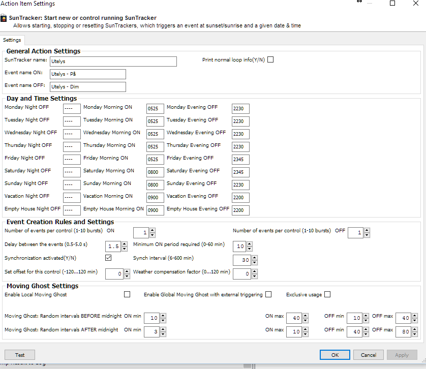

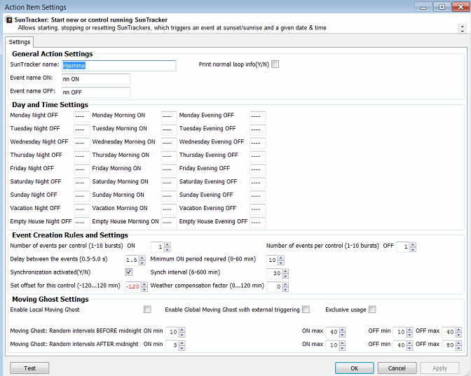

Seems like a great plugin - but I cant get it to work. I need an event by sundown and sunrise and if possible also an action that checks the status of sunrise/sunset.
I have installed the sun tracker plugin and inserted my coordinates and then inserted the action "Sun Tracker: Start new or control running SunTracker". The event name on is "nn ON" and the event name OFF i "nn OFF".
I have also set the "Set offset for this control" to -120 because I would like the event two hourers before.
But I am no getting any events when the sun sets or rises - I think I should get the events "nn ON" and "nn OFF" but I get none.
What am I doing wrong?
Is your action running? Open the plugin and check in the list
Provide some screenshots of your configuration
Henrik4223
Posts: 47
Joined: Fri Mar 04, 2016 10:18 am
Post by Henrik4223 »

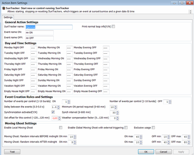

The plugin is running - I have copied in some screenshots.
Also, the only event I get is "Main.nn OFF" every 30 minutes.
This is the action I have set.
The configuration of the suntracker plugin.

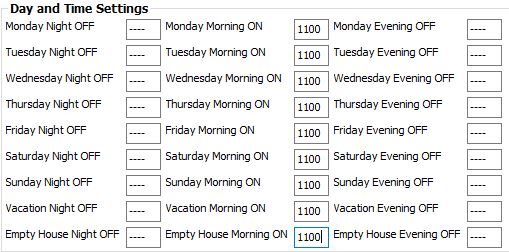

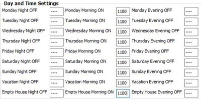

@Henrik4223
You have to insert at least one time on each day type to make it work. Like the example below. At 11.00 the sun will be up so the lights will not turn on anyway but the whole routine will then start correctly (this is how it is implemented...)

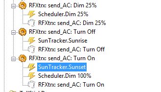

@ Heggholmen

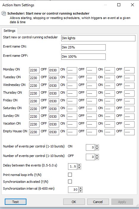

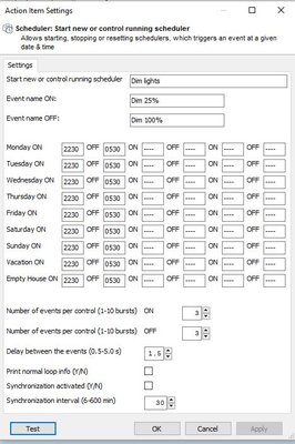

I think it is possible in many ways, I would split the tasks using two plugins and do it as follows
1) Use only the SunTracker plugin and the sunrise/sunset events (DO NOT define any action with synchronization for those lights you wan't to control this way)
2) Use my Scheduler plugin and an action for the fixed time settings (see example below)
3) Create macros with actions with dim levels for the actual control of your lights depending on what type of device you have (RFXtrx, TellStick Duo, Z-Wave, whatever...). With your example I would create 3 separate macros; Turn Off, Turn On, Dim 25% ( I see no difference between Turn On and Dim 100%...)
4) Drag the events from the SunTracker and Scheduler plugin to the respective macros the usual way
