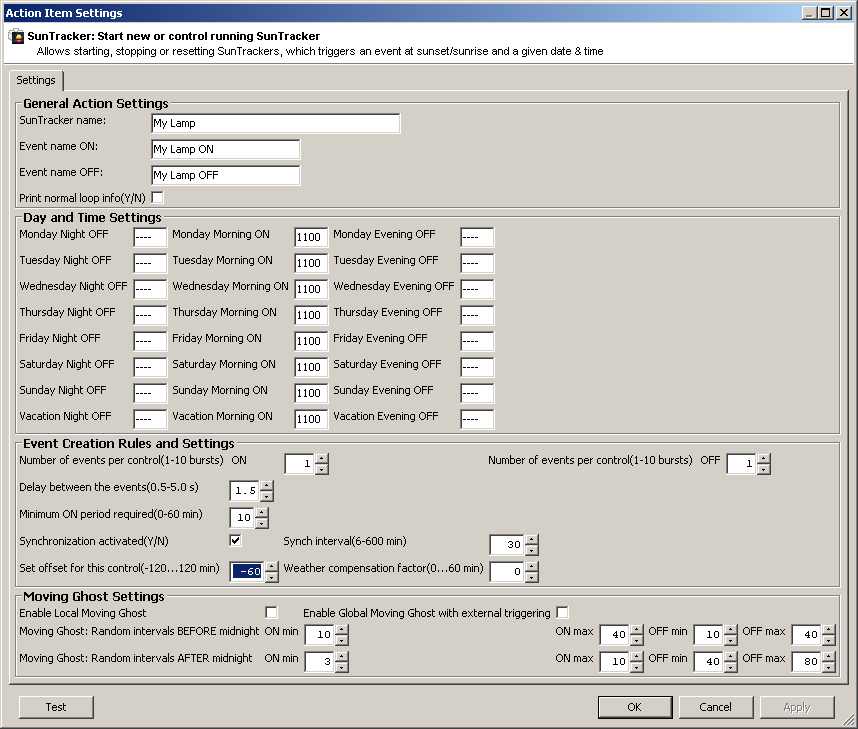

I've got some problems to set it up. I want my lights to turn off 1h after sunrise. Then in the evening I want them to turn on 1h before sundown. How do I set that up?
I'm a bit embarresed to ask but I did go through the readme :S
Thx for a cool plugin
Hi, yes this is not so obvious how to set it up but you can do it in the following way as shown in the picture below
- We need to set a time for the function to start (I put in ON at 11 but if the sun is up, lights will not be turned on until later anyway)
- With an offset of -60 minutes the lights will be turned ON one hour before sunset and stay ON until one hour after sunrise next day
(If you start to use weather data as well, that time setting compensation will start to work together with the offset setting dynamically depending on the weather conditions)
Thanks seems to work really neat now!

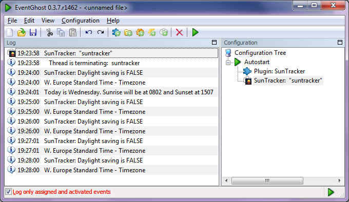

Hello Walter.
I'm using your latest version of SunTracker_09.11.2010 and I was wondering why my log keeps getting filled up with SunTracker: Daylight saving is FALSE and W. Europe Standard Time - Timezone every minute.
I haven't seen this behavior before. I've unchecked "Print normal loop information". Any ideas?
I uploaded the wrong version (without the fix for that problem)....The correct version is there now
