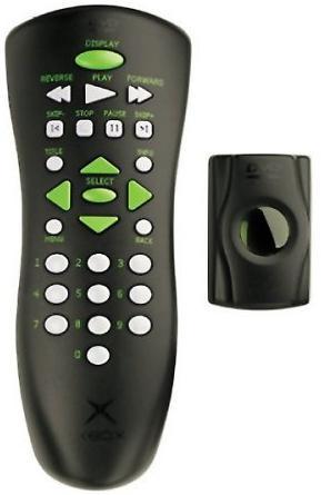

Re: xbmc: how to do multiple key presses remote
I think XBMCRepeat is more useful then the included XBMC plugin, when you don't have many buttons on the remote. As long as you start to assign actions from XBMCRepeat\Buttons\Remote as that's the layout XBMC used with the original XBOX remote that don't have many buttons. jonibtopsyturvy wrote:Is xbmcrepeat only really useful with say a harmony remote which has more buttons?
