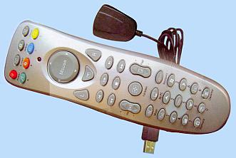

bskchaos wrote:
I have the exact same remote as the one in the above image (a Cyp Se WitheHome cheapo).
I couldn't get it to work for the longest time on XP... until this morning. :)
This is how I got mine to work...I think.
I read this thread about 20 times...
http://www.eventghost.org/forum/viewtop ... home#p9546
I downloaded the USB Remote Driver.exe from here...
http://www.eventghost.org/downloads/USB ... Driver.exe
I did as Bitmonster suggested (unpack the USB Remote Driver.exe with 7Zip and changed the driver.inf to match my remote (the one pictured above) (%Device001.DeviceDesc%=Install001,USB\VID_04B4&PID_0100), saved and installed the changed USB Remote Driver.exe.
I also had to change the EG USB-PC Remote plugin __init__.py file mach the changed guid to the one in that other thread.
I haven't a clue what most of that means but it WORKED!!! (for me)
If you need any more help LMK... Good Luck.
