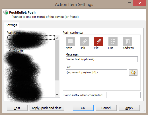

Here's how:
1) I assume you have installed and functional plugin (entered API key).
2) You must create a new macro (here is a Short Manual and an article Controlling your living room with EventGhost. It is helpful to read).
From PushBullet plugin, select the action "Push"
3) Opens the configuration dialog. There, select the target, optionally enter a message text, and in File: box type {eg.event.payload[0]}
4) Add an event to the macro. The second part of the name, you can choose yourself. I will assume that the event will be called "Main.PushPicture"
5) All confirm and save the configuration of EventGhost (File -> Save As ...), the name you choose.
That's it.
That's it.
Assume that you will want to send the file "D:\Data\MyPicture.jpg".
Command line looks like this:
