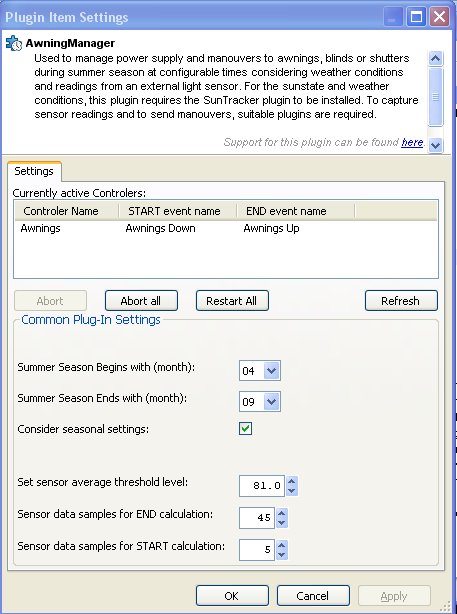

This is the basic plugin and its settings and the example is my own. The plugin can handle several so called Control actions. Each Control action has its own settings and all are using the common plugin settings. All running Controls are listed in the list box. This allows you to manage various awnings, blinds and shutters with different settings, all depending on your local house architecture, conditions and placements.
"Summer Season Begins with (month): " Here you simply select the month of the year when you would like to start enabling the automation
"Summer Season Ends with (month): " Select the month when automation shall be disabled again
"Consider seasonal settings: " Check box to enable seasonal settings, unchecked it will be enabled the whole year
"Set sensor average threshold level: " Use for your specific light sensor and set the threshold at the suitable level when you normally would like a change of maneuvering
"Sensor data samples for END calculation: " Set the number of readings to be used for the average END calculation
"Sensor data samples for START calculation: " Set the number of readings to be used for the average START calculation
A remark to this is that you would normally like to have a faster START and a slower END calculation to avoid awnings to move up and down too quickly for shorter temporary light level changes due to smaller clouds passing by.

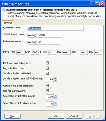

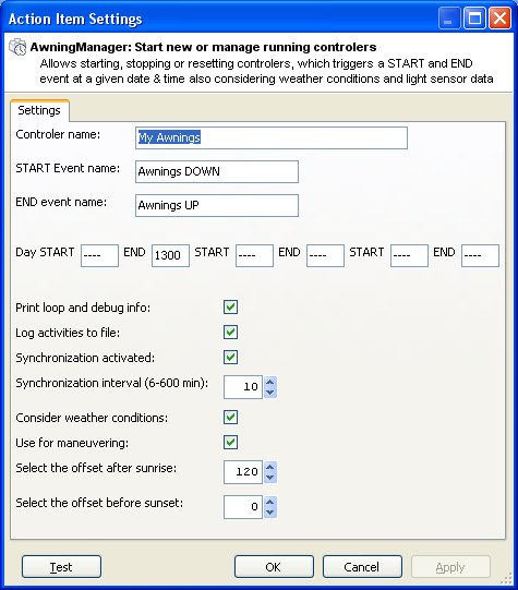

This is the Control action and its settings. This example is my own used to manage awnings placed on the south/east side of our house. We basically need those awnings sunny days from the morning until 13.00 in the afternoon.
"Controler name: " Just give it a describing name
"START Event name: " Name the event with a good describing name and then use it in your macros
"END event name: " Name the event with a good describing name and then use it in your macros
"Day START" Here you have a number of fields for setting time settings. The typical format is a 24 hour clock, like 0630, 1400, 2200 etc
"Print loop and debug info: " Use this to debug if something is not working correctly or in the beginning, if you want to check that everything works ok
"Log activities to file: " As it says, if you like to have the maneuvering commands also in a log file
"Synchronization activated: " If you want to synchronize the devices (as described earlier)
"Synchronization interval (6-600 min): " The synchronization interval
"Consider weather conditions: " Check if the this Control action shall consider the wheather or not (for normal awnings/blinds/shutter management you would typically check this box. For seasonal power control to motors you would not)
"Use for maneuvering: " Only check when the Control action is for maneuvering of the awnings/blinds/shutters
"Select the offset related to sunrise: " You can select a offset for the maneuver to delay it after the sunrise. I use a delayed maneuver myself because some large trees are giving shade the first 2 hours after sunrise.
"Select the offset related to sunset: " Same reason for this setting, you can select a offset for the maneuver to start it before the sunset.

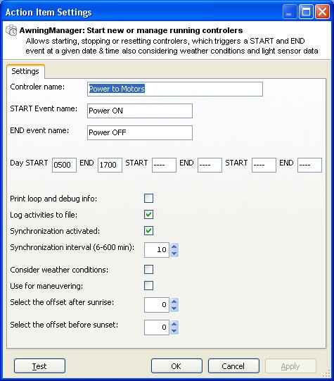

This example is my own for a Control action that I use to control seasonal power supply to the motors and transceiver electronics built into the awnings.
The power is only ON from 05.00 in the morning until 17.00 in the afternoon during the brighter part of the season (from March until September).

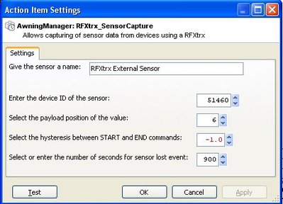

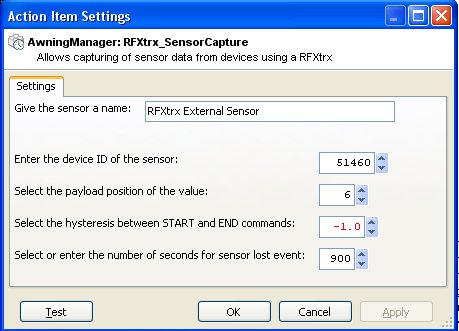

This is the description of the action to capture light sensor readings from a RFXtrx device and calculate the average values used by the logic determining when the maneuver shall START or END.
A first note is of course that you have to have a suitable sensor. I have modified an Oregon sensor according to a description you can find at the link below (unfortunately only in Swedish but the pictures and schematics will give you ideas how to do it. If you run into problems understanding I will try to assist you): http://www.switchking.se/forum/viewtopic.php?f=8&t=450
An exception I took was that I replaced the humidity sensor instead of the temperature sensor to get readings in percentage. The Oregon sensor will normally send you a new reading every 45-50 seconds so therefore an average calculation is necessary and made every time new data arrives. With my modification, the normal threshold level (configured in the plugin settings) is around 81 and I have selected a hysteresis of -1.0 to avoid that the awnings are moving up/down frequently when the average light levels are jumping closely around the threshold level.
Here are explanations of the settings:
"Give the sensor a name: " Well, name it
"Select the payload position of the value: " Here you insert the position in the payload that holds the value. Remember counting starts from zero
"Enter the device ID of the sensor: " Insert the device id of the sensor, it is visible in the event string and you can copy paste it from there
"Select the hysteresis between START and END commands: " As mentioned, select a reasonable hysteresis to reduce sensitivity around the threshold level
"Select or enter the number of seconds for sensor lost event: " This setting is for the monitoring of communication with the device. If no message is received within the specified time, an event will be generated in EG that you can use, eventually to push a notification to your smartphone
My example above is based on my Oregon sensor that typically report events via the RFXtrx like this one:
17:24:38   RFXtrx.Type: THGN122/123, THGN132, THGR122/228/238/268 id: 51460 ' temperature: +24.5 deg C humidity: 78 %RH status: wet signal: 5 battery: 9'
The sensor id is 51460, the humidity 78% is actually the current outdoor light level in the late afternoon and the value is found in position 6 of the payload (if we split the payload string with ÔÇÿ ÔÇÿ into a list).
Once you have configured the action and created a macro for it, you can just drag the event from your sensor to the same and the collection of data will start.

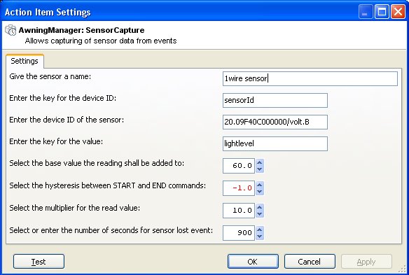

This is the description of the action to capture light sensor readings from other devices like OneWire sensors. Also in this case, the logic calculates average values used when the maneuver shall START or END.
As mentioned above you have to have a suitable sensor. I have based this example on a OneWire sensor looking like this one:
The OneWire sensor gives me a new reading every 60 seconds so therefore an average calculation is necessary and made every time new data arrives. With my modification, the normal threshold level (configured in the plugin settings) is around 81 and I have selected a hysteresis of -1.0 to avoid that the awnings are moving up/down frequently when the average light levels are jumping closely around the threshold level.
"Enter the key for the device ID: " Here you insert the keyword that can be used to extract the device ID
"Select the base value the reading shall be added to: " Depending on the signal value you receive, it might be necessary to add a base level value (I use 60.0 as base level)
"Select the multiplier for the read value: " Depending on the signal value you receive, it might be necessary to use a multiplier to increase the value (I use 10.0 as multiplier)
The example above is based on my OneWire sensor that typically report events looking like this one:
17:46:59   Main./1wire "{'sensorId': '20.09F40C000000/volt.B', 'lightlevel': '1.14072', 'temperature': '19.75', 'timestamp': '1402156022.65'}"
The key for the device ID is ÔÇÿsensorIdÔÇÖ, the sensor id is ÔÇÿ20.09F40C000000/volt.BÔÇÖ, the key for the value is 'lightlevel' and the actual reported light value this late afternoon is '1.14072'. With the base level value and multiplier, the result is ÔÇÿ71.4072ÔÇÖ. This has proved to be perfect with a configured threshold of 81.0
