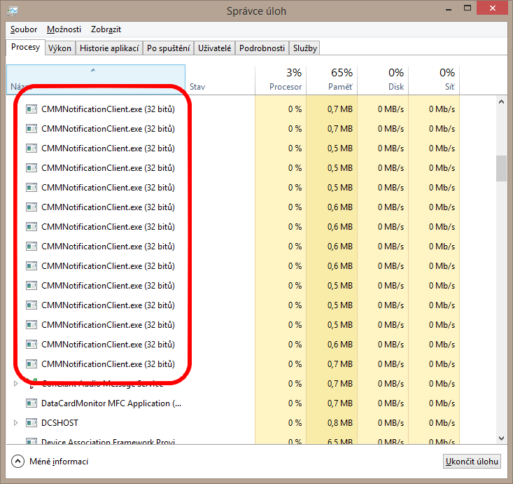

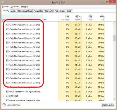

Re: AudioEndpoint
Hi Sem;colon !
Today I looked in the task manager.
There I saw this:It is possible that it happened after several forced reboot EventGhost.
It would be possible to prevent multiple starting that program?
