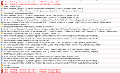

by builderjer
Ok, so I went to take the screen shots that you mentioned, and it started logging the events this time without the "Log Raw Events" being checked, but along with that sent some errors also. It seems to work ok, but I don't think it should have the errors.
One note: I am accessing my HTPC through a remote desktop as it is a modified laptop made to look like a piece of A/V equipment, so it has no keyboard and mouse; hence why I am setting up the remote only.
The computer I am using to access it is running the Linux flavor, OpenSuse 13.1. It is my main administrative computer as it accesses all of the others in the house.

builderjer wrote: It seems to work ok, but I don't think it should have the errors.
Looks like some of the events are not handled properly, could you copy some of the errors from the log so I can see the complete error text?

This is the error that seems to pop up.
Raw event: '{"jsonrpc":"2.0","method":"Playlist.OnClear","params":{"data":{"playlistid":1},"sender":"xbmc"}}{"jsonrpc":"2.0","method":"Playlist.OnAdd","params":{"data":{"item":{"id":5,"type":"movie"},"playlistid":1,"position":0},"sender":"xbmc"}}{"jsonrpc":"2.0","method":"Player.OnPlay","params":{"data":{"item":{"id":5,"type":"movie"},"player":{"playerid":1,"speed":1}},"sender":"xbmc"}}{"jsonrpc":"2.0","method":"Application.OnVolumeChanged","params":{"data":{"muted":true,"volume":100},"sender":"xbmc"}}{"jsonrpc":"2.0","method":"Player.OnStop","params":{"data":{"end":false,"item":{"id":5,"type":"movie"}},"sender":"xbmc"}}'
It only happens when the "log raw events" is checked

builderjer wrote:This is the error that seems to pop up.
Thanks. The events don't seem problematic, weird. I'll look into it more later.

Sorry builderjer, looks like I forgot to look into your errors.
I'll try to look into it soon.
