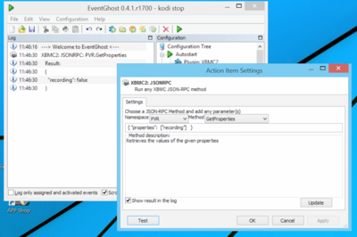

I didnÔÇÖt found an appropriate answer for my problem, so I try to ask by myself.
I got a HTPC running Windows 8.1 with MediaPortal an Kodi 14.2; I have an One4all remote with a Flirc IR.
My system wakes up and goes to sleep automatically when I program a timer to record a tv show. So far so good. Now my problem: I want to send my HTPC to sleep when I donÔÇÖt use it. It works like a charm and also I can wake up without problem. The only issue: If a recording is active, it will stop this and sends my PC to sleep.
I would like to have a macro that is able to check if a recording is active or not.
I played a little bit around and found out that JSON could be my solution
If a recording is active I get
"recording":true
if not
"recording":false
But how can I use it to jump from my shut down macro to cancel or to hibernate?
I hope I have explained it clearly enough.

Re: Put Kodi to sleep while recording
Posted: Tue Jun 16, 2015 11:00 pm
by jonib
hidalgo wrote:If a recording is active I get
"recording":true
if not
"recording":false
This should give you the True/False part that you can test:
{eg.result["recording"]}
You don't need the "{}" if used in a Python script.
For example put this in a "Python command" action, after the JSONRPC action:
eg.result = eg.result["recording"]
After this put a Jump action, configure it to jump to another macro depending on true(successful) or false(unsuccessful).
Posted: Sat Jun 20, 2015 7:17 pm
by hidalgo
Thank you jonib. Now everything is working like expected. :D
