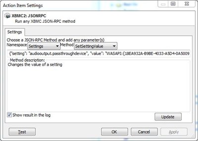

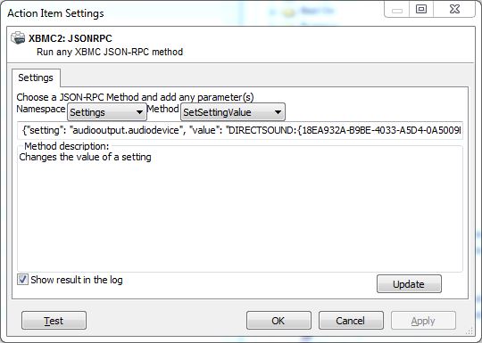

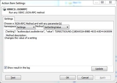

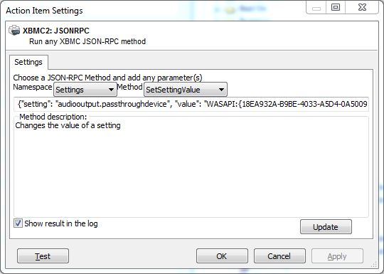

jonib wrote: This thread talks about using a external command maybe a (temporary) solution?
Cheers, I figured it out from that link.
You need to look at the Kodi log file to find the big long alpha-numeric of the sound device you want to use:
Click start, type:
%appdata%
press enter, which will give you the C:\Users\YOURuserNAME\AppData\Roaming folder.
Click on Kodi, then kodi.log and scroll until you see all your sound devices.
{"setting": "audiooutput.audiodevice", "value": "DIRECTSOUND:{18EA932A-B9BE-4033-A5D4-0A5009B22EA8}"}
Wasapi device passthrough:
{"setting": "audiooutput.passthroughdevice", "value": "WASAPI:{18EA932A-B9BE-4033-A5D4-0A5009B22EA8}"}

Luca Brasi wrote: [Edit:] Dude I feel dumb now. The setsettingvalue is sitting in the settings namespace in the plugin's json menu... Should have had a look there too :-) I'll check it out right away...
It only appeared for me afterwards too. I was going to do a screenshot, but it worked without it, just by copying and pasting the code, so I didn't want to confuse. You shouldn't need to use curl...that's amateur hour, bush league stuff. :)
