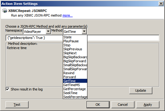

OK finally I'm finished with the next experimental/test version of XBMCRepeat, this time the new actions are a bit more useful then the last test version.I have added 3 new actions in an Experimental action group.
JSONRPC get more info here.
Just put any relevant parameters for a command in the parameter textbox. if you want to use results from a previous command, the standard {eg.result} wont work so you need to use this instead {{eg.result}} (double curly braces).
What a method returns varies, so the log option shows any results in EventGhosts log.
The first time adding the JSONRPC action you need to press the update button while XBMC is running to get the list of current methods the XBMC supports.
HTTPAPI get more info here.
Just put any relevant parameters for a command in the parameter textbox. if you want to use results from a previous command, the standard {eg.result} works.
The first time adding the HTTPAPI action you need to press the update button to download(from the internets) the list of current commands the current XBMC supports.
SendMessage the last new action will send a notification to XBMC with a custom title and message.
As these are experimental actions I might need to change them in later versions, to fix bugs or I need to change them to work better.
If you dare :twisted: to test this please report any problems or suggestions. And I absolutely forbid anybody to look at the code(as it's ugly and might scar you for life :mrgreen: )
