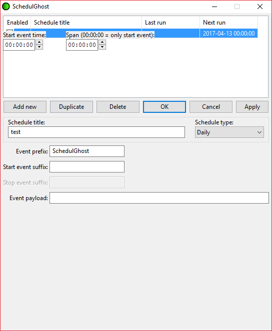

there are some problems with the dialogues in this plugin and EG 0.5.
The "Public holidays ..." windows doesn't show up at all
And the "Show SchedulGhost manager ..." Dialog looks very strange and doesn't work as intended.
Will you look into this?
I'm not very good with wx or Python UI in general...
Thank you!

Re: SchedulGhost
Sem;colon wrote:Hi Pako,
I expect that the transition to 5.0 brings many similar problems.
I have fears that it will require a lot of work and spend a lot of time thus. That's why I still do not plan to transition to 5.0.

Re: SchedulGhost
I am going to make my best effort to make wrappers for things like this. But for the life of me I can't even pinpoint which part is having the problem. I think they may have changed how wxSizer.Clear() works. I am not sure tho. I do want to make this transition as simple as possible for the plugin developers. If someone could tell me exactly what class and function is causing the issue and how exactly it used to work then I could create the wrapper.

Re: SchedulGhost
Post by topix »
I took a look at the plugin an tried to fix the layout problems. Attached is a version with dynamic window resizing. The only "problem" now is, that your screen resolution must be at least 1024x768, otherwise the bottom part of the dialog might be hidden for some schedule types.
SchedulGhost 0.1.17
(146.56 KiB) Downloaded 150 times
Re: SchedulGhost
what was it that was causing the problem?
and you forgot to increment the version number
