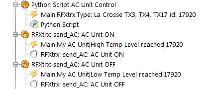

Hello James, below is a sample script you could try with your AC.
To get it going,
1) Make a new macro, name 'AC Unit Control' or something and put the python script inside
2) Drag the RFXtrx event to the same macro (in your example the RFXtrx.Type: La Crosse TX3, TX4, TX17 id: 17920)
3) Make two other macros, one for "AC Unit ON" and one for "AC Unit OFF"
4) In each of them respectively, put the action that sends the ON and OFF commands to the AC Unit and drag/define the events generated from the script execution. See picture as example of a typical configuration.
First time the temperature goes below the low limit, the AC will be sent an OFF command and when it reaches just above the high level, an ON command will be sent.
Similar scripts and macros can be defined for fans, heaters etc.

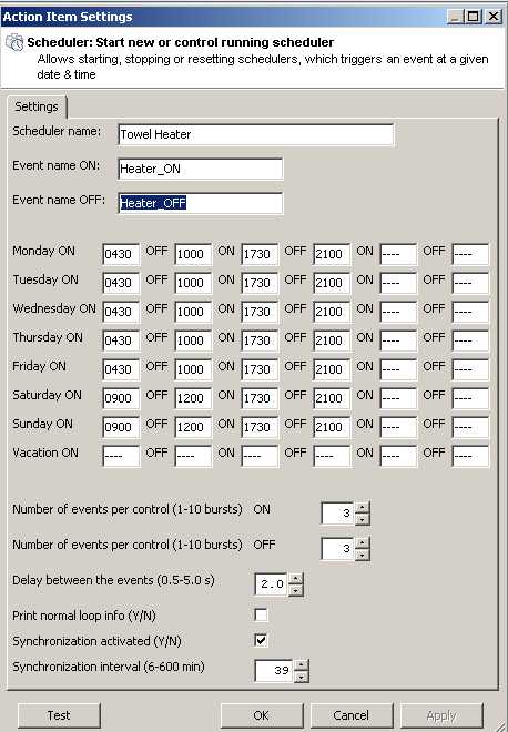

To control the towel heater, use the Scheduler or SchedulGhost plugin and set the times (I use that myself since many years). If you really like hot towels after the morning shower, I recommend that you turn on the heater a bit earlier (mine are controlled with the Scheduler according to the picture below).
You can also use the Scheduler to block the humidity fan during nights (just turn off power to it during night). No scripts needed for this.

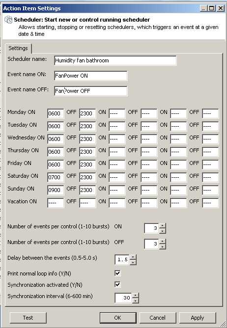

Re: RFXtrx
That can be solved in another easy way; At the same time the scheduler powers off, we can disable the macro with the script and then enable it again when power is turned on.
BestR Walter

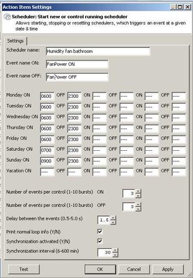

Re: RFXtrx
You could do like in the picture. You use the events from the Scheduler twice; once for turning the power supply on/off with RFXtrx using regular switch devices, secondly to disable/enable the macro where your humidity evaluation script is in.
This script has to be written in a similar way as the temperature sample I gave you earlier but now instead, measuring the humidity levels.
EDIT: Or even simpler, only use the events from the Scheduler to enable/disable the macro, the script will do the rest.

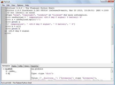

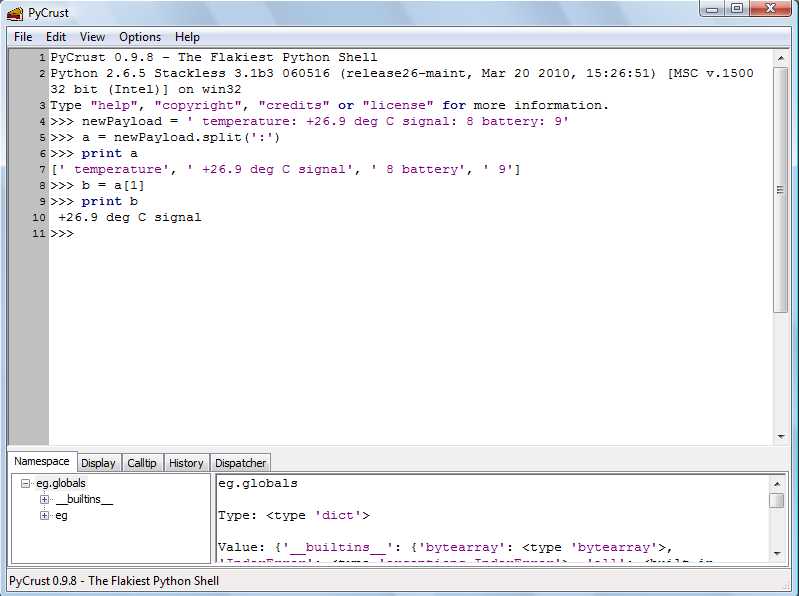

In the script, you decide what you would like to broadcast.
You are not interested in trying some python coding!? If you look into what you managed to extract yourself earlier it would be really easy to do the same here and extract the data and broadcast that instead,
Try to test using some more variables and do some splits...I leave it to you as a little exercise and when you have tried, we can continue the discussion.
a = newPayload.split(':')
b = a[1]
c = ....
BR Walter
PS Just an additional hint:
When experimenting, it is very convenient to use the python shell that is included in EG (select "Help, Python Shell"). In the picture below I started with the trials as discussed above. As you can see, you can print out the result to check that you got it right. Once finished you have the syntax you need to put into the script.
