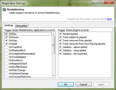

I found that was released a new version of MediaMonkey - 4.0.
New version of the plugin, compatible with MM 4.0, can be downloaded here.
Main configuration dialog of plugin has changed. Do not forget to make a new settings !
Attention: This new version no longer needs for its work the file EventGhost.vbs !!!

GBWebmaster wrote:But I have one great problem after installing MM4 and the new plugin.
After every new start of EG, MM4 starts also automatically without any action.
What's wrong with my configuration?
Nothing, you do everything right.
If it bothers you, you can correct it as follows:
The reason why this is so, is this:
If a user works with MM, some events are generated in EG.
For it to work, must be a connection between MM and EG.
Just this connection is created at the start of EG.
There was another possible solution:
At the start of EG is tested whether MM runs.
When runs, EG creates a connection.
If MM not running, it must be at appropriate intervals to test again whether MM is running ...
I chose the first solution.

Pako wrote:If a user works with MM, some events are generated in EG.
Hello Pako,
could this connection between MM and EG also created at the start of MM?
I ask you because I have problems with your approach.
GBWebmaster
F├╝r den, der nie das Rudel anf├╝hrt,
wird sich die Aussicht nicht ändern.
Re: MediaMonkey
GBWebmaster wrote:Hello Pako,
It depends on which way you run MM.
1) You are running MM manually (not using the action Start/Connect MediaMonkey).
In that case, you must run action Start/Connect MediaMonkey too (after MM launching).
2) You are launching MM using the action Start/Connect MediaMonkey. In this case you do not do anything else.
