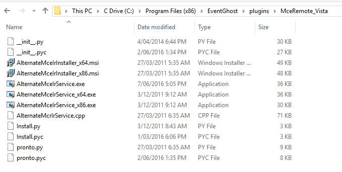

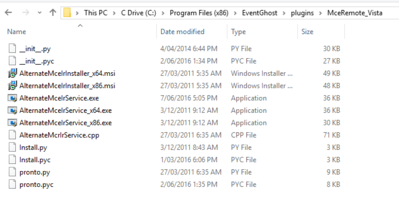

Re: Microsoft MCE Remote - Vista and newer
When I installed it through the plugin I got double keypresses, but by navigating to the plugins folder and clicking the alternate x64 installer, it's working fine now on Win 10 64bit, with the HP receiver.johnblinares wrote:I assume that on my 64 bit laptop installing the service through the plugin will choose the correct installer automatically; the 64 bit one?
Thanks for any help in advance.
- kgschlosser
- Posts: 5190
there are other people running EG with this plugin on windows 10. and the ehome driver is the ehome driver all the remotes use the same thing. and they all function in the same manner when using that driver. this has to be a specific issue with your setup. i am trying to think would could cause this problem. and the onyl thing i can come up with is that possible not everything that was supposed to get installed when the ehome drivers did.
you can try this method as it has worked to cure odd behavior.

Also, I have an idea of something that may have caused the problem:
Some time ago I changed the position of the USB jumpers on the motherboard, to allow for the remote to be able to wake the computer up from sleep via IR, which it is impossible to do in their default position. I could try reverting to the old position and see if it helps, but I would really like that functionality.
When exactly is the "loading point" - when the logo appears?
