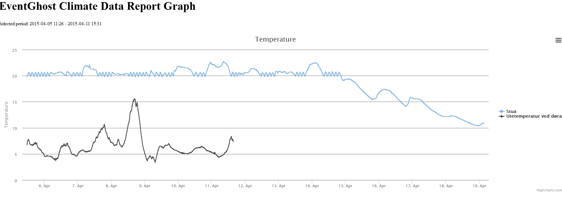

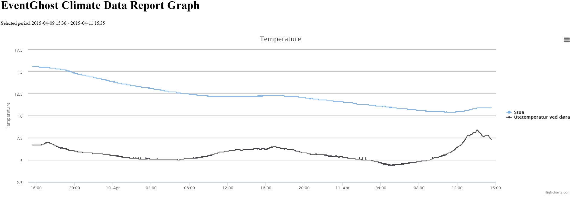

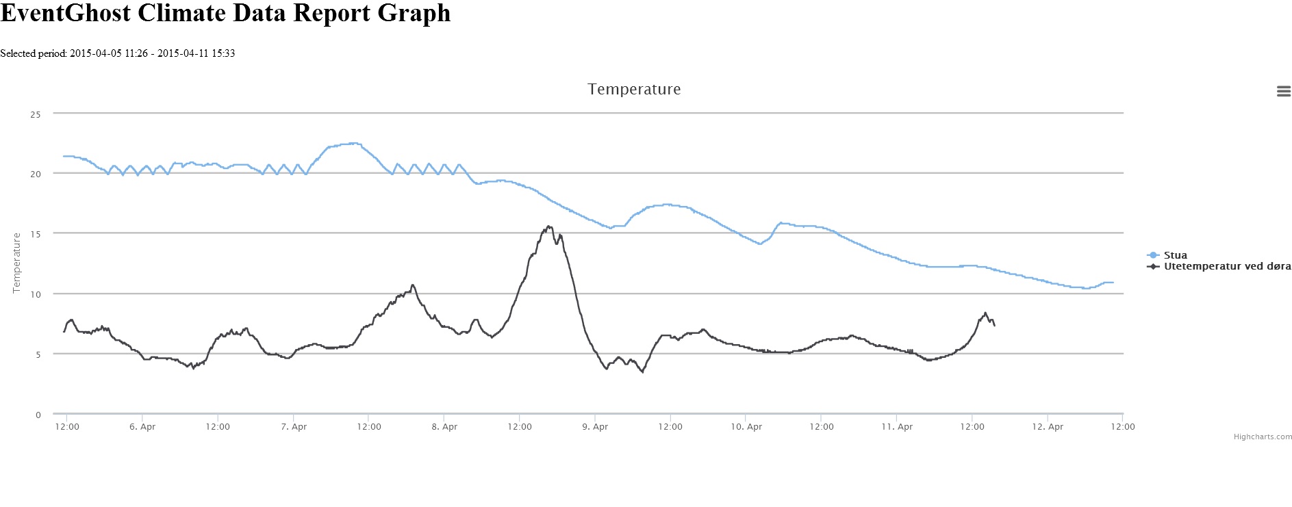

While I'm at it: There's something strange about the "outside" report that I've made. I have put in Stua (living room) just to have another graph in it here, and as you can see the one outside stops to early in both 14 and 7 day report, while it goes (probably) all the way in the two day report. And the data is there, as the 2 day report shows. Can that be something with the handling of the ├©?

No, has nothing to do with that. The thing is that 'Stua' has many more data points and when I generate the graph, I start each graph from the first available point. So when you combine data sources like that both graphs will start at the same date & time. This is actually wrong, they should instead end at the same. I have no solution for the moment, a first thought is that I should check which one has most, then add 'zeros' in the beginning to the shortest to make them equal...but it will get complex, I think.

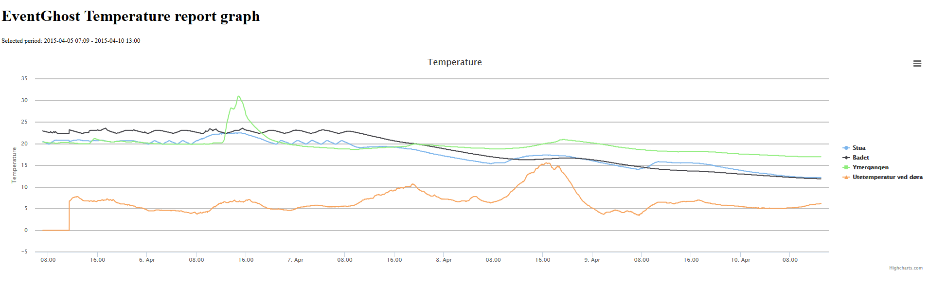

I have made a new version of the CreateComboHtml.py
The target was to handle multiple data sources with different data ranges. As example, start and/or end for data points might be different. When combining those in the same chart I do the following processing
- checking which data source starts first (this becomes the starting point for the diagram)
- checking which data source ends closest to today (this becomes the end point for the diagram)
- for each data source, checking and adding zero value data points in the beginning if needed to position the graph correctly in the diagram
- filling out eventual gaps in the data sources
Please check and see if you like it (keep a copy of the old if you like to go back). A sample looks like below

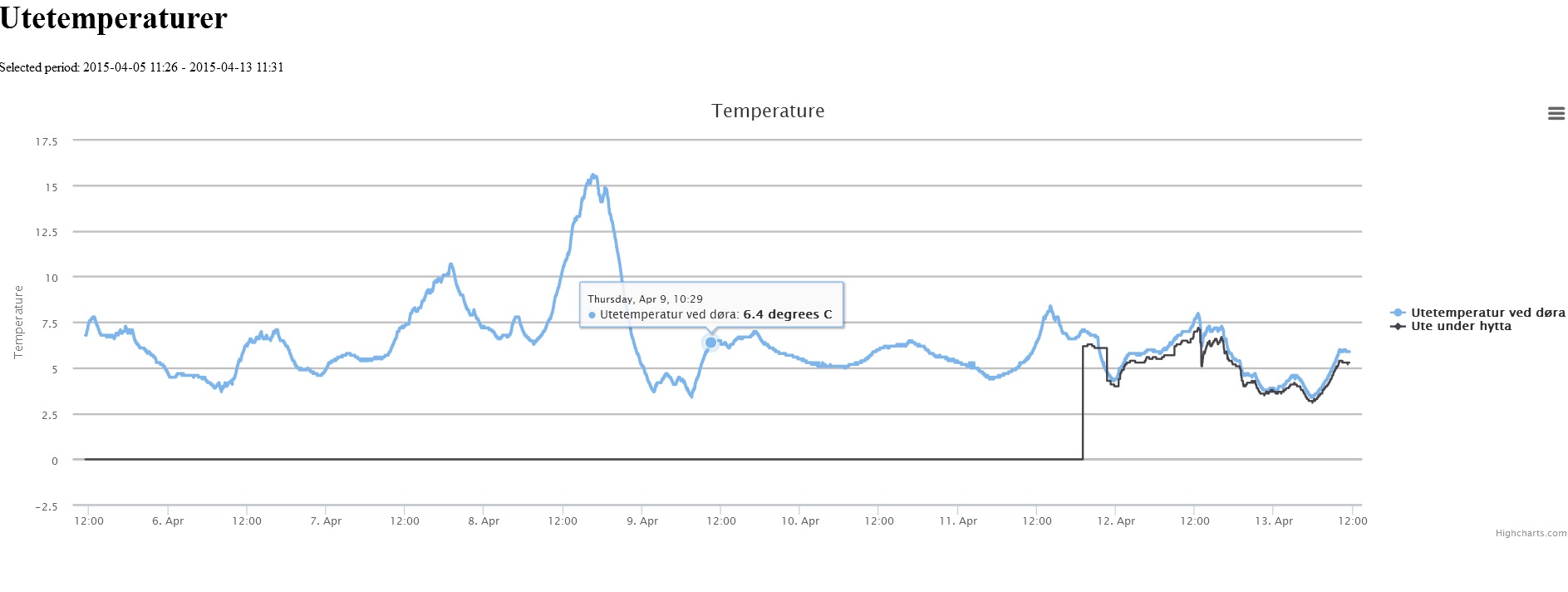

Beautiful! :mrgreen: :mrgreen: :mrgreen: :mrgreen: :mrgreen: Love it! Check out this one, with the outdoors temp, where the one that was out so long because of the wrong source format comes in:
This looks great, doesn't it? Thanks! :D

It is interesting to see how well aligned they became, even due to the earlier break. Also interesting to see (and expected I guess) is that the actual outdoor temperature is slightly higher outside of your main house entrance door than under your hytte

Yeah, I agree. This is really ready for prime time, I think. Great job, man! And yes, it's always a bit cooler under the acbin, but that's because the temp sensor by the door is higher up, and above a wooden deck, while the one under the cabin is half a meter above the ground. I use them both because the one by the door is about what it "feels like" outside, while the other one is needed to turn on the heat in the water line that goes under the cabin and to the well.
