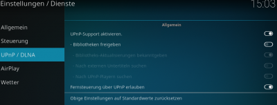

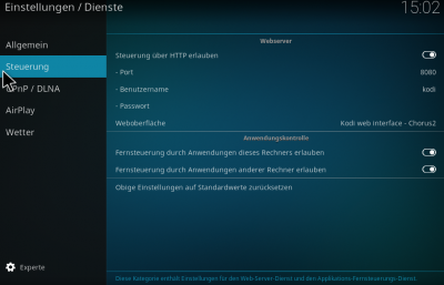

I'm trying to control Kodi 18.2 (from 2019-04-22). I installed the XMBC2 plugin and made the required configuration. Pushed the "Test" button and it told me that all is OK. At Kodi there was also some popup which told something like "connection  test works".
So far all seams to be OK but if I trigger e.g. XMBC2: Info or any other predefined XMBC2 macro it will not do anything at Kodi, EventGhost tells in the Log window the command was transmitted. Any idea what goes wrong? Thank you!
My Kodi settings:
P.S. I'm a beginner in view of EventGhost and Kodi, I'm sorry if I have missed some basics.

_Michael_ wrote: Sat Jun 08, 2019 1:47 pm I'm trying to control Kodi 18.2 (from 2019-04-22). I installed the XMBC2 plugin and made the required configuration. Pushed the "Test" button and it told me that all is OK. At Kodi there was also some popup which told something like "connection  test works".
That means your IP and JSON-RPC settings are correct, great.
Hmm, does the port number after the IP address in the XBMC2 settings match the port number in Kodis HTTP setting (8080)? post a screenshot of the XBMC2 settings window if needed.
If you are using EventGhost 0.4.x you probably should update the XBMC2 plugin as the included is very old. Latest version here download via the "Raw" button and put it in (Eventghost install dir)}Plugins\XBMCRepeat directory
Posted: Mon Jun 10, 2019 8:44 am
by _Michael_
Thanks a lot jonib. My plugin is up to data, my port number after the IP is also OK. But not OK: I entered at the beginning (before I recognized the functionality of the "Search" button") under "EventServer" the port number from Kodi. So 9777 became 8080 and this was the problem.
From my point of view:
  • All settings of the XMBC2 "Settings" tab sheet which are not in the field "IP address and port of XMBC (...)" should be hidden for a default user e.g. as it is made in Kodi: Introduce a button which changes the "Settings" tab sheet between "Standard" and "Expert".
    Also: Rename XMBC to Kodi.
