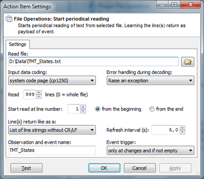

Posted: Tue Jul 03, 2012 7:11 am
by Pako
I think it should look like this:
You must (of course) to adapt it.
You also need to ensure that the action "Start periodical reading" was launched at the proper moment.
If you do not mind reading will run always, you can use (for example) the event Main.OnInit.
I do not know the correct name and location of that file.

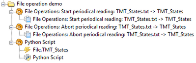

Posted: Tue Jul 03, 2012 5:08 pm
by Pako
1. In your configuration is missing the event File.TMT_States
- MissingEvent.png (2.77 KiB) Viewed 9311 times
2. You do not have any events that triggers the action
Start periodical reading. So be sure to run it (at least) manually.
3.
Python Script you are totally spoiled. Initially use my original version without editing.
When it works, you can carefully make small adjustments.
Re: File Operations
Posted: Tue Jul 03, 2012 5:59 pm
by waffles
Duh!! Yep, I missed the "File.TMT_States" event, which I have now added. It's working now!! Excellent, thank you sooo much for your help and patience!
