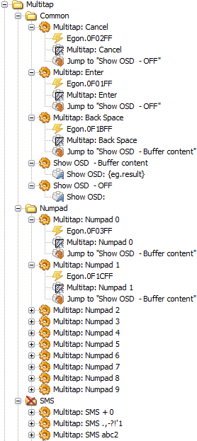

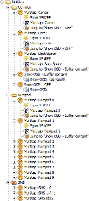

"Use own OSD" = turned on the OSD, which owns the plugin Multitap. I guess this is not the appropriate wording. It should be "Do not use the OSD" and function inversely. Own (= "mine") OSD can be used similar to picture: But it is not convenient for the SMS mode, because it does not see the menu keys.

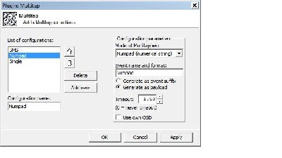

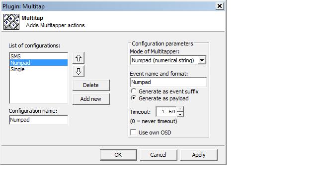

Attached is my configuration file The only event I have configured for Multitap is "Emulate Keystrokes: 2"
I have also attached a screen shot of my Multitap settings I am a fairly advanced user of Vista Media Center but new to Eventghost.
When I use the SMS setting I get the digits to show up on the OSD but they are not passed to Vista.

Multitap has three different modes of activity:
1) The mode SMS
Works as SMS on your mobile phone. You can use single button on the remote control to write different characters. The entire sequence of character must end with the event "Enter".
2) The mode Numpad
Using this mode you will able to write integer (for example number 100). It is not necessary to conclude with the event "Enter".
3) The mode Single
Using this mode you can use a single button on the remote control to generate an event from own list. It is not necessary to conclude with the event "Enter".
I put an example of the application to your configuration.
