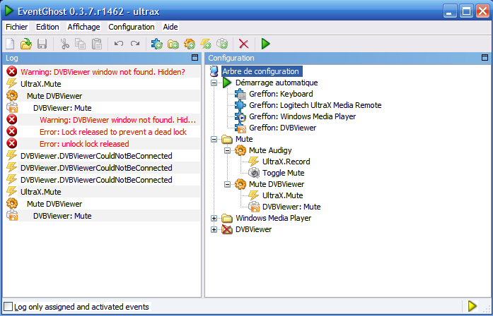

Hi, i have a problem with the new DVBViewer plugin. I use DVBViewer Pro 4.0.0.0, and it seems to be not recognized. The Eventghost arrow become yellow for about 1 min, and return an error (see image attached).
The previous version of the plugin was working fine.
I am running on Windows XP SP3 with EG 0.3.7.r1462.
Thanks.
Thanks.
Re: DVBViewer
Which version have you used before?QuentinSat wrote:The previous version of the plugin was working fine.
I think it could be a language problem. Which langugage have you selected in the dvbviewer setup?
Regards
Prinz

Re: DVBViewer
I used the EventGhost 0.3.7.r1436 version before, in French. DVBViewer was in French too, and it worked.
I just tried to set DVBViewer in English, but i got the same error. I thought it was because of it was show in the system tray only, but no.
Thanks for your answer.
Re: DVBViewer
Could you switch on the log of the time and post the result log again?
Regards
Prinz
There is no difference in the plugin between 0.3.7.r1436 and 0.3.7.r1462.QuentinSat wrote:I used the EventGhost 0.3.7.r1436 version before, in French. DVBViewer was in French too, and it worked.
Regards
Prinz

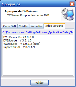

Oh sorry, I restored a backup and i saw that was EG v0.3.5.
I bring you a copy of the about box of DVBViewer, maybe it can help you :
Re: DVBViewer
Could yo activate the debug mode of the EG using the switch "-d".
The log will be in the same directory where the configuration XML file is located. Could you put it together with the XML configuration file as a attachment?
Regards
Prinz
This is a very very old version.QuentinSat wrote:Oh sorry, I restored a backup and i saw that was EG v0.3.5.
Regards
Prinz
