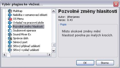

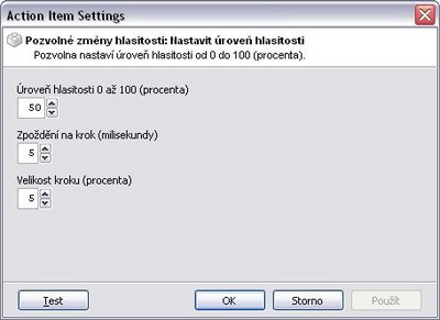

Re: smooth volume change
I had to make some minor changes to make it right.
I found that the directory name must match the name of plugin.
Therefore, I renamed the class "SmoothVolPlugin" to "SmoothVolume" (name "Plugin" in the folder "plugins" has no meaning).
I still have one comment. Also return informations 'already muted' and 'not muted' should be in the class "text".
Here are examples of how it looks in the Czech version of EventGhost:Pako
- __init__.py
- Version 0.43
- (5.81 KiB) Downloaded 269 times
