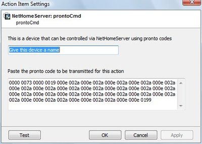

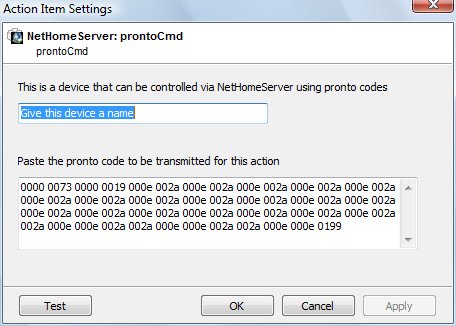

Yes this will not be too difficult. I expect to have a first test version uploaded sometime during the day
I have just found out how to send pronto codes to NHS, you can test this as well and replace the pronto below with the codes you prefer
This event is taken care of by NHS as an event that shall go out. When I send it via telnet, I hear the code in my speakers/headset. I changed nothing except that I configured the RFTransmitter to use the correct audio output
event,Pronto_Message,Direction,Out,Pronto.Message,0000 0073 0000 0019 000e 002a 000e 002a 000e 002a 000e 002a 000e 002a 000e 002a 000e 002a 000e 002a 000e 002a 000e 002a 000e 002a 000e 002a 000e 002a 000e 002a 000e 002a 000e 002a 000e 002a 000e 002a 000e 002a 002a 000e 000e 002a 002a 000e 000e 002a 002a 000e 000e 0199
New version with pronto command support uploaded in the first post above (just add an action for each pronto code to like to send)

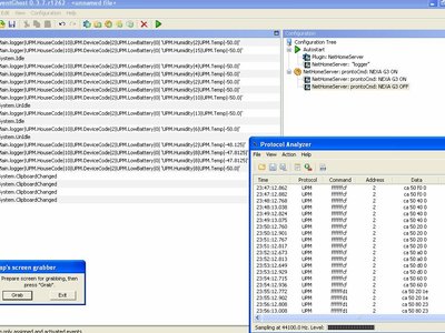

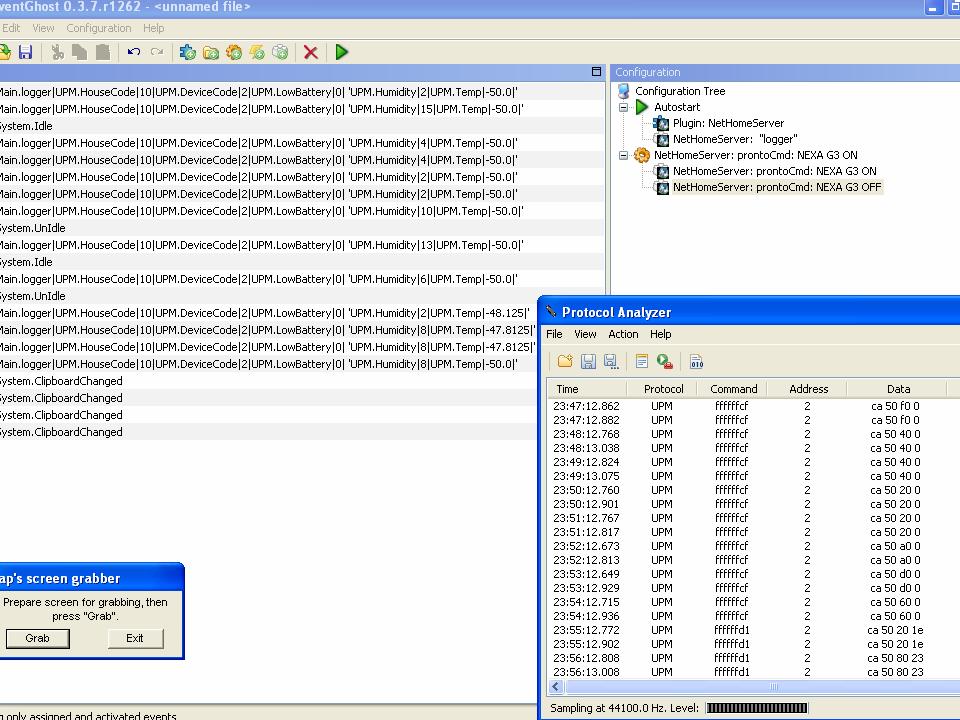

I also picked up my UPM wind sensor today. This is what the logger entries and the analyzer look like:
As I rotate the wind direction sensor through N-E-S-W, the humidity number changes from 2-10-13-6. With no wind, the temperature shows -50, going to -47.8125 as I blow on the wind speed sensor. Looking at the analyzer results, notice that the command value also changes when there is wind.
So, the support is almost here, we just need to decode the data format and calibrate. Looking at the NHS homepage, there is mention of support for the UPM weather sensors in the next release, but no date on the post or next release. Do you know when it is due?
Thanks again for the Pronto support, that is just great!
/Michael
Hi, yes exactly, the data decoding gets mixed up as a temp/humidity sensor
Can you log the thing (wind speed/direction) using a telnet session (copy/paste the result) so I can see if it is possible to decode already with this NHS version?
I have no info when the next release is due but I will ask next time

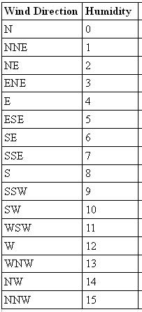

Hi.
Regarding the wind direction i have maped it completeley. I used the original "Station" set the arrow for N checed that i got N on there an what i got in EG. And so on.
The walue goes from 0 -15
mickelin you said that you had 2 on N. Are you sure that you had it towards N when you checed. There is an arrow under the arrow for the N direction. If not they might not work the same way.
We should be able to use a phyton scipt to map the humidity to N and so on. I am not that good at that thou so it would be great if somebody can do that.
http://en.wikipedia.org/wiki/Boxing_the_compass
I wil post the wind range later today.

Hi Jostein,
So you have the actual station! Perfect, then that solves the decoding problem. I was too cheap and only bought the windsensor as a spare part, as you suggested in your previous post.
You are quite right that N is 0, I had only pointed it in the general direction. I have now checked with a compass.
Looking forward to your post on the windspeed decode!
Cheers,
Michael

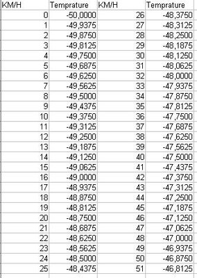

Jostein
Posts: 108
Post by Jostein »

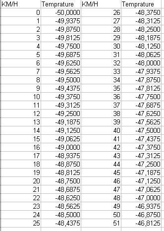

I got the whole set as i feared i would not figure it out or get the values at all in to EG.
Using a floor fan and adusting the lenghts to the instrument i was able to get the speed calculations.
Here are the results from reading the speed from the "station" and temp from EG:
Wind Speed.JPG (13.06 KiB) Viewed 5662 times
From my calculations it seams that for every extra km/h 0,0625 is added. And we get the table:
I have noe idea on how to have a phyton script convert from temp to speed. So i hope you or someone has the skils for that. Or else it is useless. Loking forward to an example or any sugjestions on how to solve it.
Will try to sort out the rain sensor someday if that is wanted?
Regards Jostein
