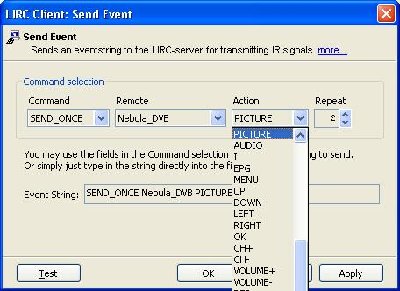

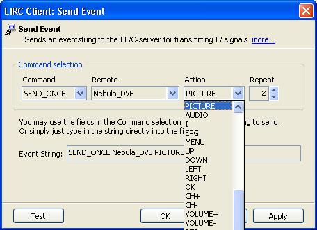

jinxdone
Posts: 443
Re: LIRC Client
Post by jinxdone »
Yep, It tries to do exactly that.
The reason is that it tries to fetch all remote and button/event data from the server so that you can easily use it for sending events. I attached an example of it at work.
I will add a checkbox to disable/enable this feature as disabling it should speed up the plugin startup by a few seconds if it's not supported.
