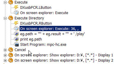

Re: OSE (On Screen Explorer)
Ok I got it working but note I had to add "/Play" to the result to make it read and work correctly for directory. Doubt I will use the delete feature myself but nice addition to OSE. Now you will notice in how I execute the directory I also have a show for display 1 or display 2 based on if it's fullscreen or not.
Your code you gave me before still works good for it but I have to get new values if I move the windows display around any. Just too bad Python just doesn't have no direct calls to get a windows state. All I did was create it as it's own macro and whenever I do volume changes or show any OSD including OSE I make a call to the macro to check if fullscreen or not.

No I was showing what I had to do to make directory play work. I had to take the result and add the value of \Play and it worked.. also taking the result and adding the value the directory corrected itself to d:\ and not that funky square character. Also was thanking you for the code earlier that allowed me to have some work around to determining that mpc is in full screen to change the display value. It's kind of a round about method but it does work to a degree.Pako wrote:@molitar:
