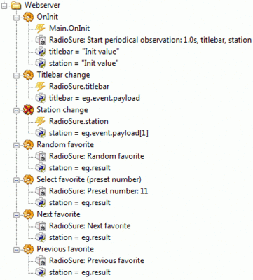

Re: Radio?Sure!
Posted: Tue Jun 28, 2011 8:29 am
by Pako
piert wrote:When using only preset favorite radiostations to choose from, we do not need to get the station name from the URL stream, I think?
I would be perfectly happy when I would be able to retrieve from your plugin the chosen preset after using the option "choose random favorite".
It would then be a matter of setting another variable and adding that to the webserver's page, am I right?
If you agree, then what variable could be used to find the randomly chosen favorite?
In the new version is an improved action Start observation of titlebar. Is now called Start periodical observation and that's because it is also possible to monitor change (name) station.
Yet it has one annoying feature: Changing the station is displayed with a delay of about 15 seconds. This is because the station name is obtained from the file RadioSure.xml. Also entry into the RadiSure.xml is delayed and can therefore shorten it only the author of Radio? Sure!.
However, if you change the station only using EventGhost, you do not need to use this feature (in the attached picture the appropriate macro is disabled).
Webpage:

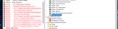

Posted: Thu Mar 30, 2017 11:09 pm
by loveleejohn
Is this plugin still active? It suddenly stopped working on my computer today with some errors that I do not understand. I am running the most recent stable version of Eventghost on a WIndows 10 machine. I have attached a picture of the error that I am seeing.
Re: Radio?Sure!
Posted: Fri Mar 31, 2017 1:38 am
by loveleejohn
