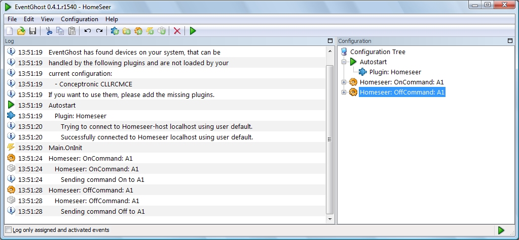

I got it to work by disabling "run homeseer as service" , any clues why it does not work when homeseer runs as service?
Kiliansitel
Kiliansitel
Re: Homeseer Plugin - Please take a look and help thank you
No idea, I noticed the same when I changed it to run as service. Reverting back to normal application, it works again.any clues why it does not work when homeseer runs as service?
Since you anyway are not able to run EG as a service, you might accept also to run HS as a normal application.
What "original" are you referring to?
I hope you are not running HS as a service because then it will not work.
PS Just made a quick test, the version provided by Ersan in the above post works fine for me

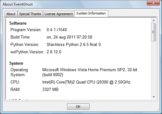

I have a feeling that my problem is a 32bit / 64bit thing. EventGhost (latest non-beta version) is installed on a 32Bit PC, as is the Homeseer Voice software, but the Homeseer itself runs on a different PC, and that one is 64bit....although the more I think about that, however the Speaker client communicates with the Homeseer server I wouldn't think would be problematic since I assume it is just IP or http (so why would 64Bit on the homeseer side make a difference)?
Again, everything EventGhost wise is on a 32Bit Win7 PC. Only Homeseer itself is on a different PC that is 64bit.
Do homeseer and eventghost have to be on the same PC for this to work? (they don't for the original version of this plugin, since that one works for me).
Thanks for the help!
I have no idea, sorry. For some people it works, I guess they have everything in one PC with 32 bit Windows but I'm not sure.Do homeseer and eventghost have to be on the same PC for this to work?
Thanks, I realize it is tricky one, probably would work for me if all 32Bit and on 1 PC. Regardless, I appreciate the response!krambriw wrote:I have no idea, sorry. For some people it works, I guess they have everything in one PC with 32 bit Windows but I'm not sure.Do homeseer and eventghost have to be on the same PC for this to work?
