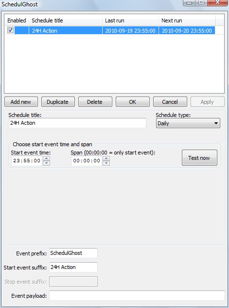

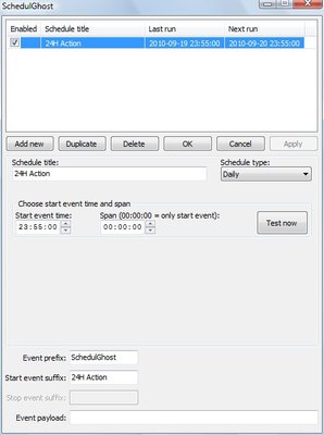

After testing a while it is working very fine and I have tested most the scheduler and the egg-timer function. I also have some suggestions to improvements
My tests:
First test is running in my normal working PC using Vista with the following configuration
It simply initiates a daily shut-down of the computer before the power is automatically turned off at late night and on in the morning using a device similar to X10 controlled by my home automation PC
Second test is running in my home automation PC using Win XP with the following configuration

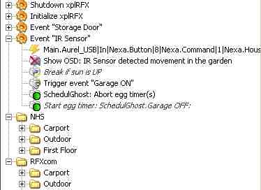

It turns on the light in my garage if somebody walks where the IR detector detects movements. The macro starts and if the python script accepts, the lights are turned on and the egg-timer to turn off is started. To avoid repeats, I abort all previous egg-timers when a new is created.
The python script is used to control if the sun is up or down and that time is within a certain range to allow this control
p = eg.plugins.Suntracker.GetSunStatusWeatherCompensated(15)
if p:
    print "Sun is up"
    eg.StopMacro()
import time
trigTime = str(time.strftime("%H%M", time.localtime()))
if trigTime > "0600" and trigTime < "2000":
    print "Time is outside range"
    eg.StopMacro()
