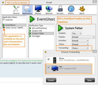

I'm gonna post some screenshots to show how it works on my network.
In this example I have three machine talking to each other via growl: The WHS, the workstation and the htpc.
These screens are from the workstation:
You can see in the applications tab that there are several apps registered to growl. Only eventghost is running on the local machine (workstation). The others run on the whs. They are shown cause I subscribed the workstation to notifications from the whs and on the whs forwarding to the workstation is enabled (by default in that case but you can configure that independently for each app).

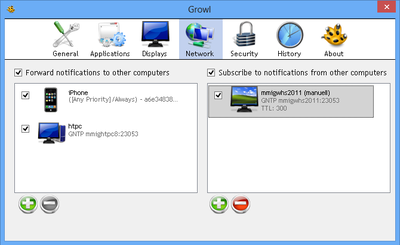

You can see on the second screen how this is configured on the workstation:
As you can see on the screens I would like to forward the eg messages from the eg plugin running on workstation to the htpc. But as it is already running its own eg plugin this won't be possible...

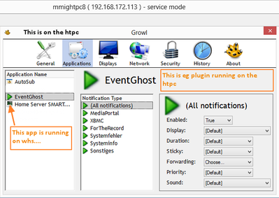

The evenghost plugin/application in this screen would be overwritten by the one shown in the screen above if I would really forward it to the htpc....
I hope this helps you to understand the purpose of my question.
