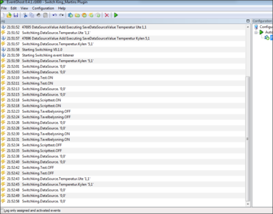

woggy wrote: hmm, does everything work if you disable the Debug mode and enable the events?
It looks like it works.
But I have a data source that is constantly reporting "0.0" I do not know what it is. Could it have something to do with the error messages?
