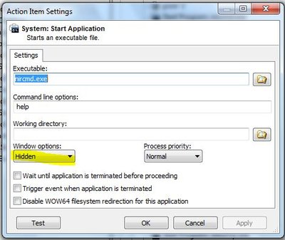

Pako,
I think I have a workaround. If I run Start Application action with the Window option "Hidden", the macro seems to work as expected.
But I still can't understand why it would not work as before.
