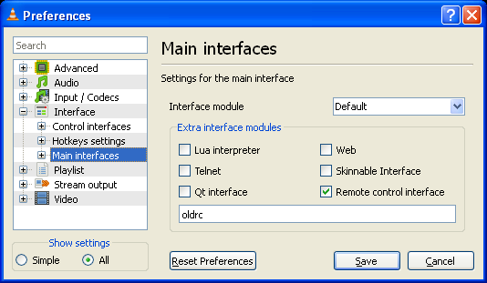

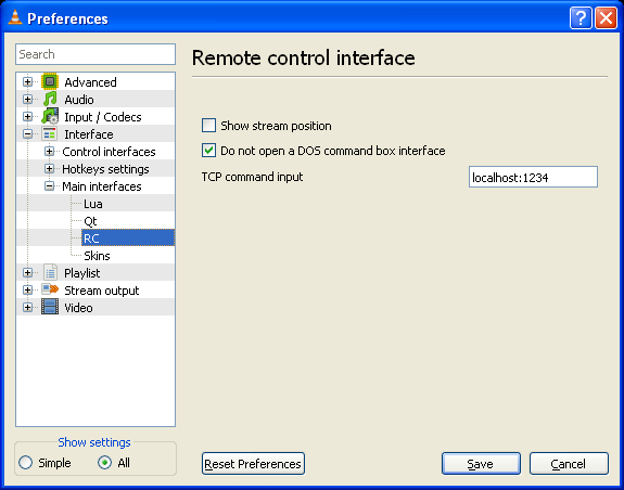

The VLC plugin works for me on the computers that are set up for EventGhost. I did have a problem with Volume Up, Volume Down and Mute, but I changed those Macros to use emulated keystrokes Actions instead.
VLC v2.0.5 Twoflower is what I have now on both machines (Windows XP and Windows7).
I do know that you have to enable the VLC RC interface and use localhost:1234 as the TCP command input.
See if that works...

Using the latest VLC 2.1.2
I tried this the other day but with 127.0.0.1 and it didn't work.
Now I wrote localhost as you suggested and it does work.
Thanks for the help.
