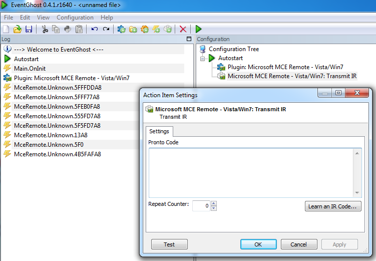

I'm new to eventghost. Is it possible to dump raw IR codes (pronto, hex, whatever) with this plugin, and how would I do that?

Pronto codes, yes:lje wrote:Hi,
Thanks.
- Capture.PNG (6.52 KiB) Viewed 7429 times

My eventghost does not have that "Learn Counter" field, might be version dependant. Unfortunately, the whole learning doesn't work.
The IR receiver *is* working, as indicated by the unknown IR events on the left side of the screen. But when I press the "Learn IR code" button, nothing happens. A window opens telling me to point the remote at the receiver with 3 inches distance and press the button on the remote, but once I press any button, nothing happens. Eventghost seems to not receive the IR code.

OK, first of all please use the latest version of the plugin, you can find it at the first post.

please extract the content in the .zip file into C:\Program Files (x86)\EventGhost\plugins\Microsoft MCE Remote Vista\ (not sure if the path is 100% correct, I can't check at the moment - but something about that, I guess you will find it) and restart eventghost.
-That's the way how to install a plugin, did you do that?

Thanks, that did it
My bad, I just replaced the service with the one from the zip, but not the plugin itself. I can get the pronto codes from my remote control now.
