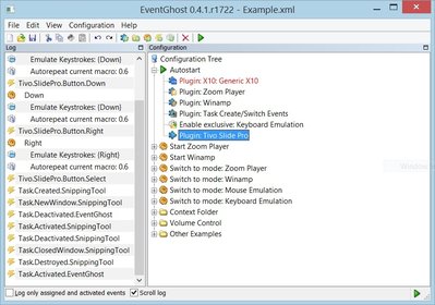

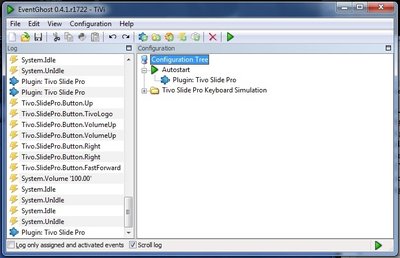

I have been trying to get this working for 2 weeks, with little luck. My first try resulted in the buttons appearing in the event log, but not kicking off any macros (see attached image).
My second try got further. Several buttons are not only seen, they also work in WMC (Up, Down, Left, Right). However, Select still does not work, so it ends up moot.
My second install also added other items without my asking (X10: Generic X10, Zoom Player, Winamp, Task Create/Switch Events). Note that in my first attempt I was able to create the TiVo Slide Pro Keyboard Simulation folder, in my second attempt I am no longer able to add the folder for keyboard simulation.
I've tried adding macros myself, I've tried editing the XML file for the TiVo plugin, and I've tried a couple other things. None have worked. What might I be doing wrong?

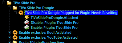

I find that every time I unplug the TiVo Slide Pro's dongle from my Windows 7 machine, it loses its connection to the TivoSlidePro Plugin. Took me a while to figure out how to solve it, but it seems pretty similar to a prior problem I had with the original TiVo Slide. I slapped this code into a Python script to detect which components of interest are plugged in, firing a more accurate event I can handle separately:gduboff wrote:Looking for help with this plugin on my W7 machine.

eg.TriggerEvent("Removed", prefix = "TiVoSlideProDongle")Then, in my TiVo Slide Pro folder, I fire a disable, enable action after detecting the Pro's dongle has been plugged in:
Anytime there is a solid green light on my dongle, I get no response from Eventghost. Things are right when there is no light and any button press on the remote triggers a flash of the dongle's green light.

Feel free to delete the Zoom Player & Winamp. X10 might be useful, but I'd delete it since you look like you're on the right track with this plugin. You'll need the Task Create/Switch Events plugin to keep track of which program you're sending input to via your remote/Eventghost, so keep that one.Bibbit wrote:I have been trying to get this working for 2 weeks, with little luck. My first try resulted in the buttons appearing in the event log, but not kicking off any macros (see attached image).
Once you have the plugin installed (like a previous poster, I had luck granting Eventghost Administrator privileges in order to successfully install the Tivo Slide Pro plugin), you need to add actions. Your first pic shows the event for the directions firing as well as the Select button; the problem is the Select button isn't handled, whereas the direction buttons are. I'd suggest making a folder specifically for the events of your remote to help keep things clean, make obvious the things you've added, and discern what might be crap worthy of deleting. Create a macro for Select, press the button on the TiVo Slide Pro remote to get it to show up in the log, drag that event from the log to your macro, and add an "Emulate Keystrokes" action, selecting Return under the "Special key tool" drop-down box, click the Insert button then OK.
You'll need to repeat this process for all the buttons on the remote, so it becomes a pain in the ass, especially when you start doing the slide-out keyboard & realize you need to handle 3 events for most of those keys: a lower case, an upper case and a symbol. I'd be happy to share mine, but be warned: I'm trying to handle Kodi (use to be called XBMC: a great free HTPC frontend), YouTube, Netflix (if they have anything I can use to navigate their damn website with other than a friggin mouse!) and possibly Steam, among others. So there's quite a bit I'm trying to handle, and I hope to make it so I can use the remote for everything except gaming with a controller or touch-typing with a full-sized keyboard; essentially everything the family would use an HTPC for controlled from a remote while sitting on the couch.
