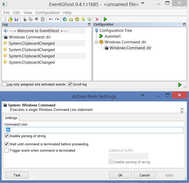

Am I doing something wrong? In sem;colon's example above, several events are generated. When I try a basic command, there are no events generated. However, the result of the command is found in eg.result. Windows 8.1, 64-bit.

kkl wrote:Am I doing something wrong? In sem;colon's example above, several events are generated.
Do you mean the process.created.* events? those are from the "Process Watcher" plugin.

Yes, that's what I was looking at. Thanks for the help Jonib.
