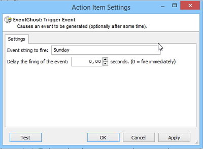

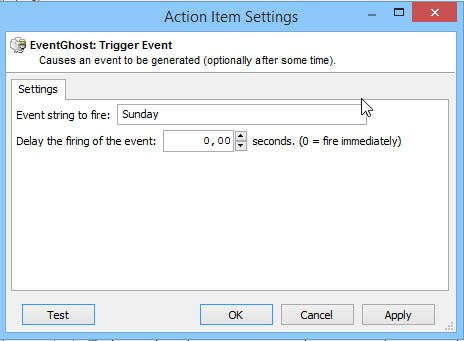

Add a macro "Eventghost: Trigger Event" like that
You can fire it manually by F5 and you will get the Main.Sunday event.

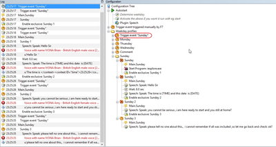

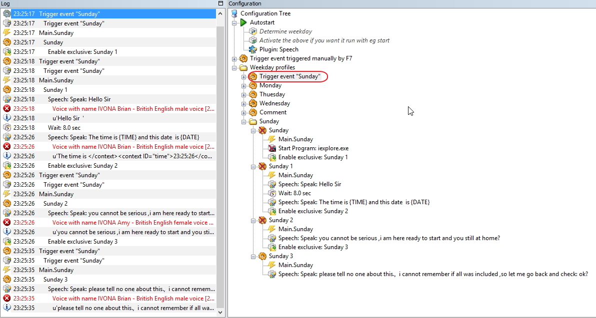

I have added 4 Sunday's macro in one folder and (I think ) that i enable the next one exclusively, please can you have a look at this sample i attached as the results is I am getting all the macros loading, am I on the right track?
Yes you are! I loaded your xml and it works here as expected.
[attachment=1]screen_mmnote_20151115_232621.jpg[/attachment]
You know what. I guess you had it set up. All sunday macros where active and so all where triggered on the Main.Sunday. It would have worked as soon you triggered it again. Cause then only one of them (the second one) would have been active...

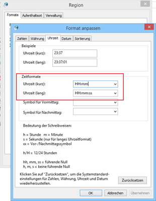

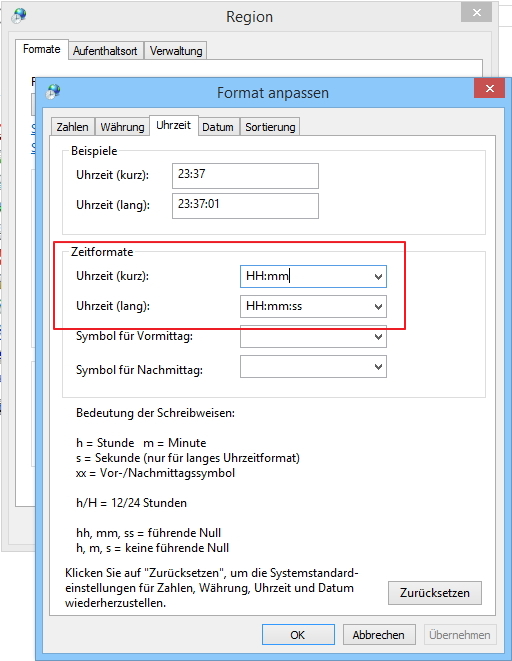

The time is {TIME} and this date is {DATE} this in text to speech reads the time is hour colon minutes colon and the date is 15 November 2015 how can i get rid of hearing the colon
Puh man, sorry, I have no experience with the speech feature. I guess you will have to pass the date and time in a format which is interpreted correctly by the speech module. Don't know what that might be.
On my system it reads the time right but the date is spelled with "point" between day/month/year. This might be fixed in your windows region settings. You can tell windows there that it should read 23:58:32 as a time. But be aware that this would be the standard for your whole system then. You can still try just for testing purposes though.
