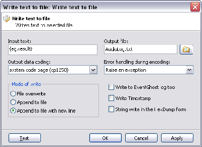

But consider one more option. I am still not wrote that plugin also provides eg.result. eg.result is the string that I get after decoding. I brought the idea that this plugin may be more universal.
Can also read the data from the specified file.
He should appoint a "Read / write file". What do you think? I got to add this feature?
Re: New system plugin "Write result to file"
I was thinking about it, and came to this conclusion:
Plugin will have two actions (Read and Write).
Action Write will look the way you recommended.
eg.result is the input string after parsing. Is this reasonable?
Layout is as follows:
Action Read I only start to do.
I thank you for your patience with me!
