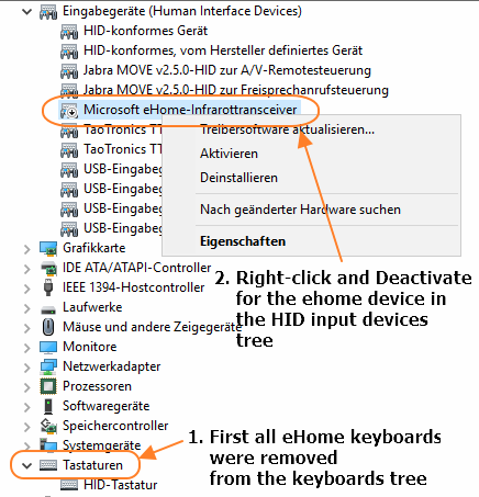

I updated Win 10 on my htpc to the Anniversary Edition the other day and the double actions were back. Right after that I tried all the solutions mentioned here to no avail (thanks for all the detailed info btw!). So I thought I would just keep on removing the eHome devices from the device manager. This had helped the last time after a couple of days and lots of reboots.
This time it didn't help. The eHome device in the HID tree seemed to be the main culprit cause after uninstalling this one the double actions disappeared. But it got reinstalled even after a resume from sleep now.
So I found this solution by trial and error:
- I uninstalled all devices from the keyboards tree in the device manager
- After that I was surprised to find the "deactivate device" option in the right-click menu of the eHome device in the HID-tree and I used it
Now the problem seems to be solved and doesn't come back after reboot or resume from sleep.
I didn't produce any screenshot in the trial an error rampage so I can't deliver those for the two steps but I attach one with the current state on my sys. Maybe one of you could try to reproduce the process and confirm that it is a solution.
